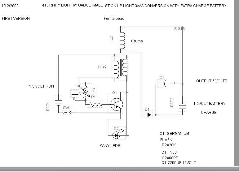

    @SW:
    That looks like a great little circuit. Is that 11 turns bifilar and 22 secondary? With a one watt Led bulb? The straw hat warm white bulbs do come in one watt size I think, or use two of the 0.5 watt bulbs.
    I'll give that circuit a try also. I have a couple one inch ferrite toroids and some 2n2222As transistors that would work for that. I do need to get some more magnet wire though. Any ways, let us know how it goes.
    My tiny solar panel with the bumble bee Jt did charge a 10v 4700 mf capacitor to 3 volts today, and it will keep the led on without any light going to the solar panel, but for only a couple of minutes. It's a start. But I'll try to charge an dead AA battery tomorrow instead to see what happens.
    I've been having real good luck charging batteries while lighting an Led with my other 4 AA Jt. (also with a one inch toroid) by swapping batteries back on and forth. It does charges great, but I do have to swap them every 6 hours or so. Still it's about as close to free energy as I've seen yet. I'll put in a switch on it soon, so I can swap the batteries by just flipping a switch. I'll send some more pictures.
    I also made a couple different two inch air core toroids today, that I'm still working on.
    Thanks for posting the sketch above, looks like it's worth replicating.

      Hi Nick, I actually made an air core toroid also, going to test it soon. I built that gadgetmall circuit 1.2volt AA, though I do not have an ultracap(boostcap), nor do i have a decent nichrome heater element, but i do have a few large car audio 1.5 farad super capacitors. I used a 1" ferrite toroid with 12 turns - 24 gauge bifilar and 24 turns of 24 gauge secondary and used a 1 watt luxeon led connected to secondary output, then hooked the 1.5 farad supercap to the regular collector/emitter output with diode, also using tip42c with 1kohm base resistor because it seems to run the circuit better. I powered up the circuit and initially the cap was about .4volts and it slowly charged the cap, while the led was not lighting and then once the cap was above the battery voltage the luxeon led started to get brighter and brighter until it reached it's full output for the settings the circuit is at right now, I'd say it's 70% of full brightness. Cap rose so far to 2.8 volts and is still climbing slowly, one thing i notice is that no matter if the cap is hooked up or not it doesn't change the brightness level of the led, so it seems that once the 1.5 AA's voltage is exceeded by the cap that any load removed from the cap after that point will have no affect on the input or the output of secondary, which in this case now is the luxeon led. More testing to be done.

          Hi folks, Hi Nick, thanks for sharing your experiment results, yes i built the gadgetmall circuit and it does work like he says, though I'm having good results right now with a different setup charging a 1.2 volt AA rechargeable while using the typical 1.2volt AA rechargeable for the input. I switched toroids to the 1/2" diameter and 24 gauge bifilar which is giving much better light output that hurts to look at and charging of the AA which is right after the leds on the regular JT output. Here is the simple circuit.

            Hi folks, I used the circuit I just posted previously and found that while it charged the secondary AA cell and it held a voltage about 3 times what the primary battery lost and when swapped it ran the circuit, however it was not as solid a charge, some what fluffy. So I'm testing right now this modification to the circuit, a super capacitor in parallel with the secondary charge battery, though an ultracap(boostcap) might even be more ideal, also the capacitor is in line with the led diodes, then i put the AA cell in parallel off of that in hopes that it will attain a more solid charge. With this setup, it is charging the battery well, so we will see if it charges better this way. Here is a cad pic of the circuit addition.

                      Hi guys Gadgetmall had a nice circuit to this lighting leds and charging at the same time.
