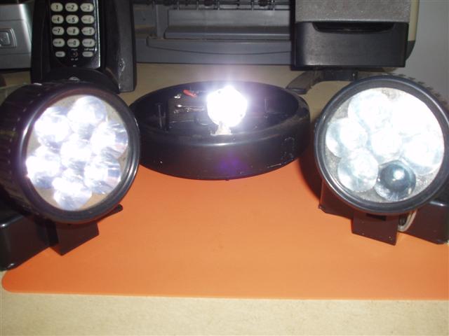

      Nope, no thoughts of saving the world on this one, just a fun little joule thief light for halloween that uses 1 AAA, instead of 3 AAA's.
      Only took an hour to solder it up, pretty decent little light.

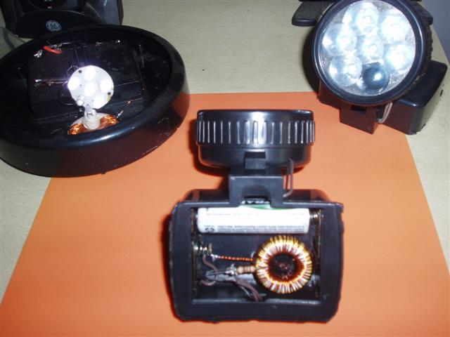

        Can you give us an update on your test runs with 1/2" toroid, 24G wire, 1.5kOhm resistor ? You were at 14 hours from a 2000mAh AA battery, for the 12 LEDs.
        May I ask you a few questions ?
        1 - Did you find better efficiency still ?
        2 - how many turns were on your toroid ? I counted 2 x 10 on the picture.
        3 - what transistor you recommend for that circuit ?

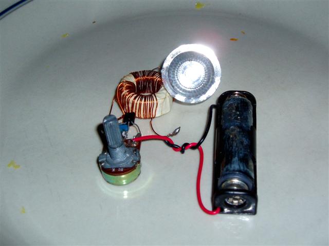

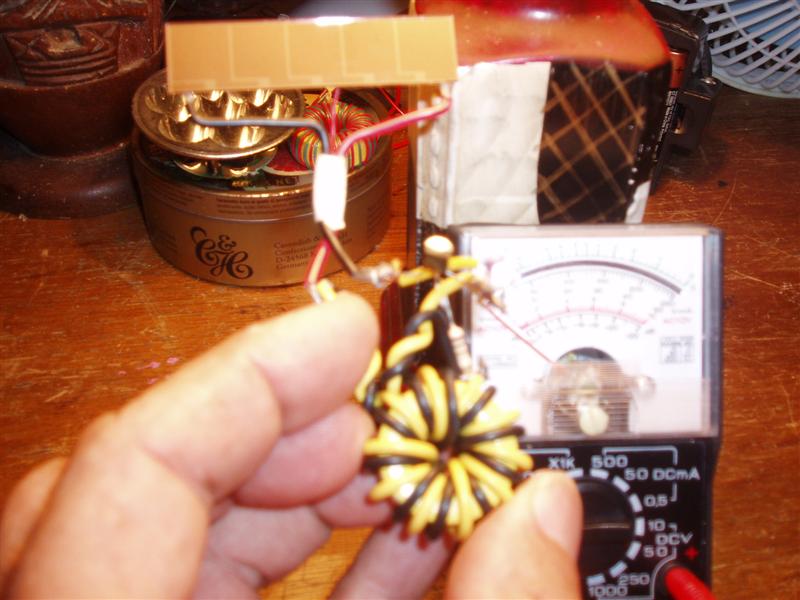

                  • Here are some ideas of Jt circuits that I made some years back. They are still useful today as night lights for the bathroom and any other rooms or patio areas where light is needed. They don't cost an arm and a leg, as most items are obtained for free, and they can be moved around where they are needed. They also work great for emergency power black out conditions.
                    The solar circuit (third pic) needs a little bigger solar cell going to a rechargeable battery, but those can be obtained in the cheap solar walk-way lights from China at the dollar stores.
                    Hard to beat the ready made solar lights or Christmas lights that can light 60 to 100 leds, all night long.
                    The last picture is of a AA sized homemade cell lighting a Jtc.
                    Most of what I have made did not cost much, or was free, which can be adopted and used even by no income homes.
                    A totally useful led lighting circuit that needs no further attention is not that easy or cheap to make, or buy, yet. I wish it was...
                    The Lasersaber or totoalas multiple led bulb type of circuits is the best cheapest way to go, up to now.
