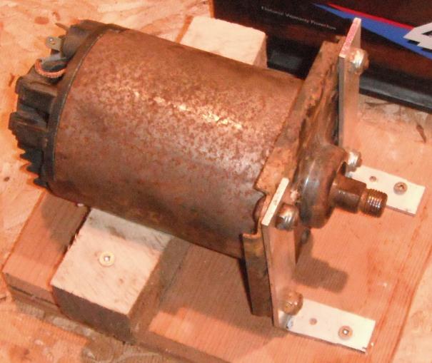

so after coming home from the energy conference in november and burying my self in a charge management circuit project for the monopole kit i recieved (yes its working without me hovering over it and no i am not going to discuss it on this forum so PM me if you have questions because its off topic here) i have now decided to take a peak at this forum.... 17 pages
allready quite the activity. it took a chunk of a day to read through it! i noticed the predictable reaction to the dvd to start trying to reproduce the literal lockridge device, i appreciate the change in direction and focus on seeking to understand/teach some principals via the "torque enhanced motor" that Peter has started, and the results to Matthew Jones work is fasinating!! i guess i have some catching up to do!
so to start with i do have a motor collecting dust on my shop shelf it came out of an old electic lawnmower. i had a bunch of specs on it saved on a harddrive that later crashed quite awhile after i junked the rest of the mower components so now all i have to work with is a sticker on the motor that says 24v and 971051-001(serial number?/part number?) google didnt turn anything up in a quick search. i think i remember reading on the mower deck houseing that is was 1hp but thats only from memory. the permenent mag stator is very strong i really had to pull hard to seperate it from the rotor.
motor specs i could measure
some pictures i attached below

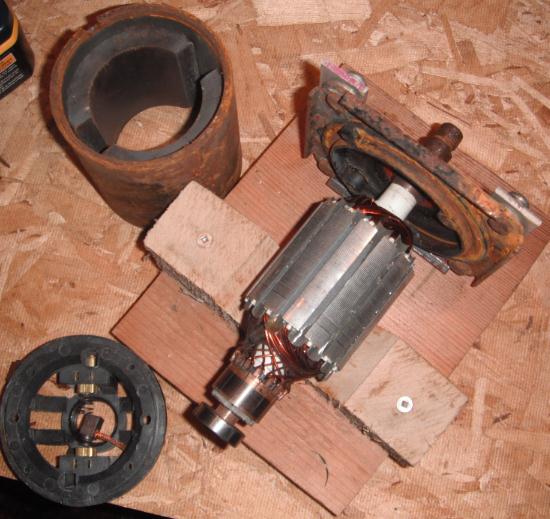

some beginning questions to consider before "passing the point of no return" when i strip the original winding off
motor length via shaft length end to end 8"
motor diameter 3 7/8"
shaft diameter .675" (just under 11/16th)
iron stator housing length 4.5"
iron stator housing thickness .2" (or a little more than 3/16")
magets are .5" thick 3 1/8" long
2 pole stator 1 north 1 south magnet
inside stator diameter 2.479" (little more than 15/32)
rotor iron is 2 3/8" long, diameter is 2.4"(.4 is shy of 13/32")
rotor iron brush width is 13/32", gap between brushes .143"(just under 5/32")
rotor iron has 14 brush secions
air gap 2.479-2.4= .079" (a little under 8 thousands of an inch?)
existing wind diameter is .045"
awg gauge table shoes this to be closest to 17 gauge (who sells/uses 17gauge?)
16 gauge 0.0508
17 gauge 0.0453
18 gauge 0.0403
turns and length per winding section i wont know untill i unwind one
i "think" i was able to count 7 or 8 turns on 1 winding section? i could have missed some turns
copper comutator has 14 segments an even number so 1 section at 180deg apart is satisfied but 14 is not evenly divisible by 2 so i dont think i can do 4 pulses per rev but that might be too many anyway for this motor so i will focus on 2 windings and 2 pulses per rev.
comutator diameter is 1.165"
1 cumutator section is .692" long .235" wide(note width measured from a caliper does include curvature of section)
comutator circumference is c=d*pie c=1.165*3.14=3.658"
so 2 sections divided by 14 sections is .1428 or 14% duty cycle
(.235*2) divided by 3.658 is .1285 or about 13% might be more accurate.
existing carbon brushes
width(side occupying part of the circumference) .35"
depth(side occupying length of comutator section) .412"
length(whats left of the carbon brush life time) .521"
plastic brush/comutator/bearing endcap housing length 1.5"
i think theres just enough room for me to add 2 more brushes for recovery
nice ball bearings smooth no slop or rough action
test run unloaded/idle
@ 12.84volts input about2.5amps(0 to 30 gauge hard to read precision) 1690rpms
@ 25.19volts input about2.5amps 3430rpms
the next test i did was to spin up the rotor in my vertical mill at 3 set rpms and record the voltage output, this would be the BEMF
1155rpm 8.3v 1155/8.3=139.157 rpms per volt
1871rpm 13.4v 1871/13.4=139.626
2821rpm 20.15v 2821/20.15=140.0
