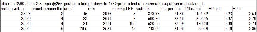

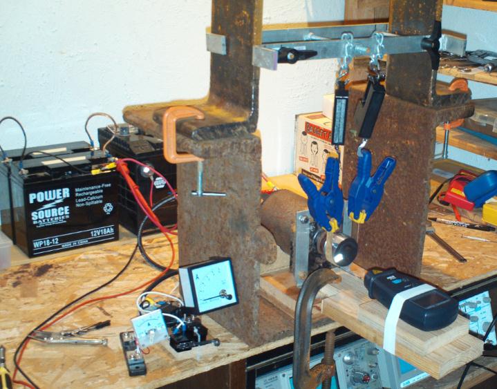

ok so i decided to set and learn how to run a prony brake test running my motor in stock mode to get some output numbers to compare with for when i modify the winding.
below is a picture of the setup and a table of results, the first time i tried to run a prony test awhile ago i used delron plastic to make a wheel of known circumference when i tried the test the plastic got too hot and melted to the leather strap didnt know it untill i hit the power again the wheel didnt let go of the strap and it ripped my 50 Newton spring scale apart. ooops. so i moved on to other things.. this time i used 28lb scales used to weigh fish and a piece of thick aluminum tubing and epoxied a piece of delron in the core and trimmed this down to a 6inch circuference bored and tapped the center to use the threads on the shaft. it spins really nice, no flex if i reef on it up and down with my hand, you have to spin the moter very slowly to see there is a very slight wobble in the wheel. after running a few brake tests the wobble hasnt grown. unfortunately i reached 28amps on the last test so i needed a bigger gauge. the 0 to 100 gauge i have appears to be giving me readings that dont match up with my smaller gauge so i will have to find anouther gauge.
i am wondering is there a point where useing this leather strap method might be unwise (ie will leather stretching yeald bad results) should i switch to a different setup like shown here de Prony brake - Wikipedia, the free encyclopedia useing a wooden arm to pull on a spring scale?
Ya use a 1 foot piece of wood and 1 scale. Makes it real easy to calculate. Tighten it down till you get a certain RPM, then you can do your calculations.Originally posted by Eric View Postok so i decided to set and learn how to run a prony brake test running my motor in stock mode to get some output numbers to compare with for when i modify the winding.
Maybe use a scale that measures in fractions of a pound and up to multiple pounds.
Matt

Hi,Originally posted by Eric View Postok so i decided to set and learn how to run a prony brake test running my motor in stock mode to get some output numbers to compare with for when i modify the winding.
I also was thinking thru how can one figure out how accurate the prony brake was.. I believe the way to do is is to take a motor of known horse power and use that to calibrate the setup. As you mention there are many variables that need to be worked out and it looks like you are making good progress in your method.
But picking up an electric motor with X horse power that is in range of your measuring scales may be the way to go to get a ballpark idea if your measuring technique is accurate.
Just a thought.See my experiments here...
how do we alter the math in calculating for the 1 foot arm to the scale are we adding it to the circumference of the wheel?Originally posted by Matthew Jones View PostYa use a 1 foot piece of wood and 1 scale. Makes it real easy to calculate. Tighten it down till you get a certain RPM, then you can do your calculations.
Matt
