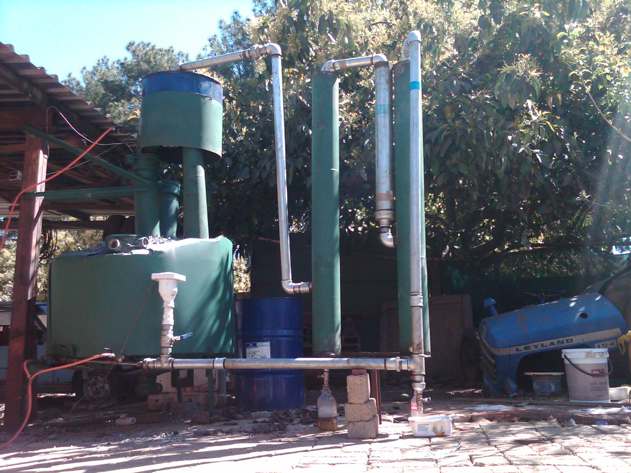

Look at my picture. I am using a gas fired reactor with ash isolation. 3 openings on top. The centre one is the Reflux and the idea is that the heavy chains (the wax) fall back into the reactor. The blue drum on top with the chimney from the reactor and green heat shield is the catalyst with its own gas burner. I put any type of broken pottery, bricks, ceramic tiles ect. with lime powder inside and it work well.
I have seperate and weigh my fuel. The bottom part is 950 gram per Liter and the top part 710 gram per Liter. That make it Diesel and Petrol !!!
The 2 green pipes are my condensers with beer bottels inside and a water cooler between them. From there the remaining gas go back to the furnice. The white pipe with the fan give extra air to make the flame blue.

Hi Alec!Originally posted by Alec View PostLook at my picture. I am using a gas fired reactor with ash isolation. 3 openings on top. The centre one is the Reflux and the idea is that the heavy chains (the wax) fall back into the reactor. The blue drum on top with the chimney from the reactor and green heat shield is the catalyst with its own gas burner. I put any type of broken pottery, bricks, ceramic tiles ect. with lime powder inside and it work well.
