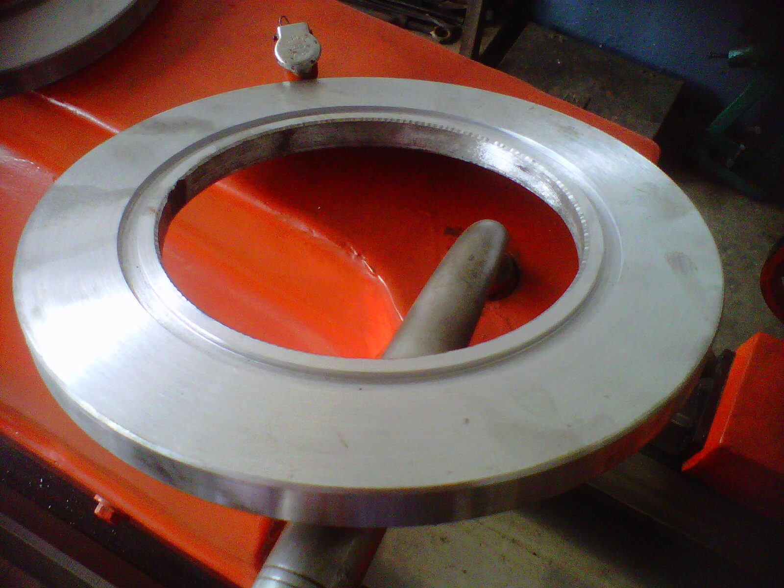

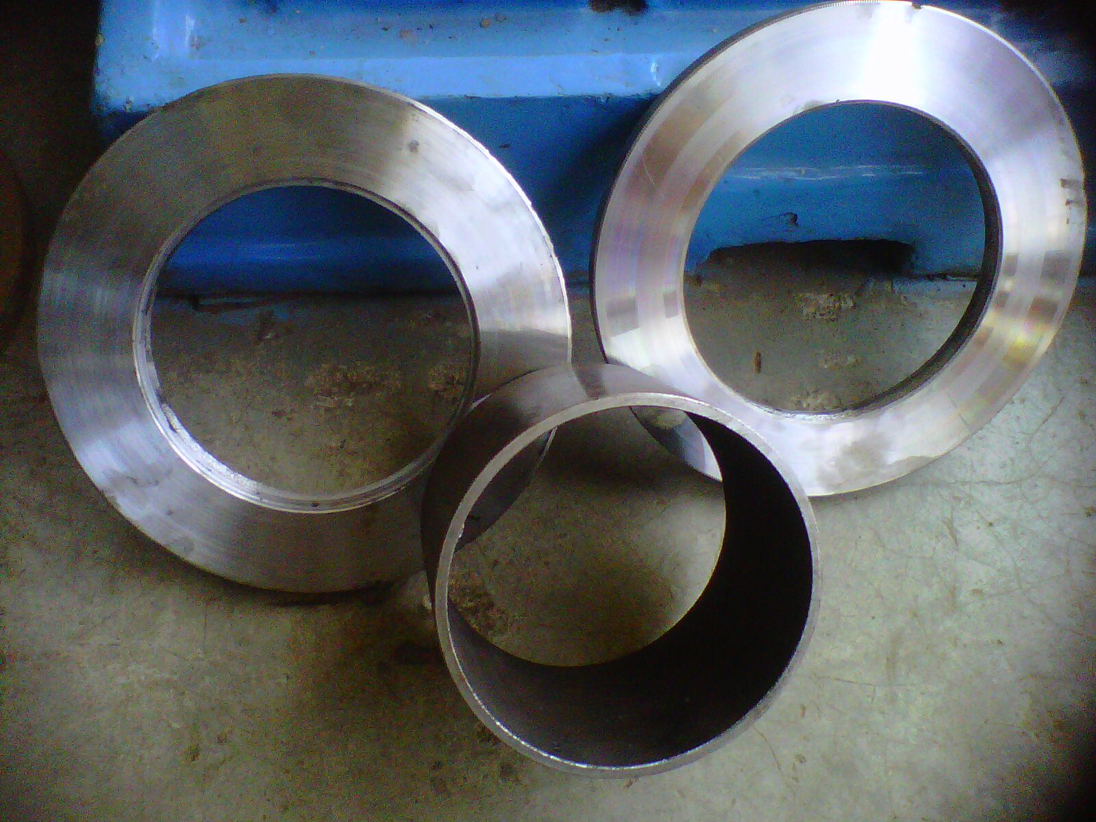

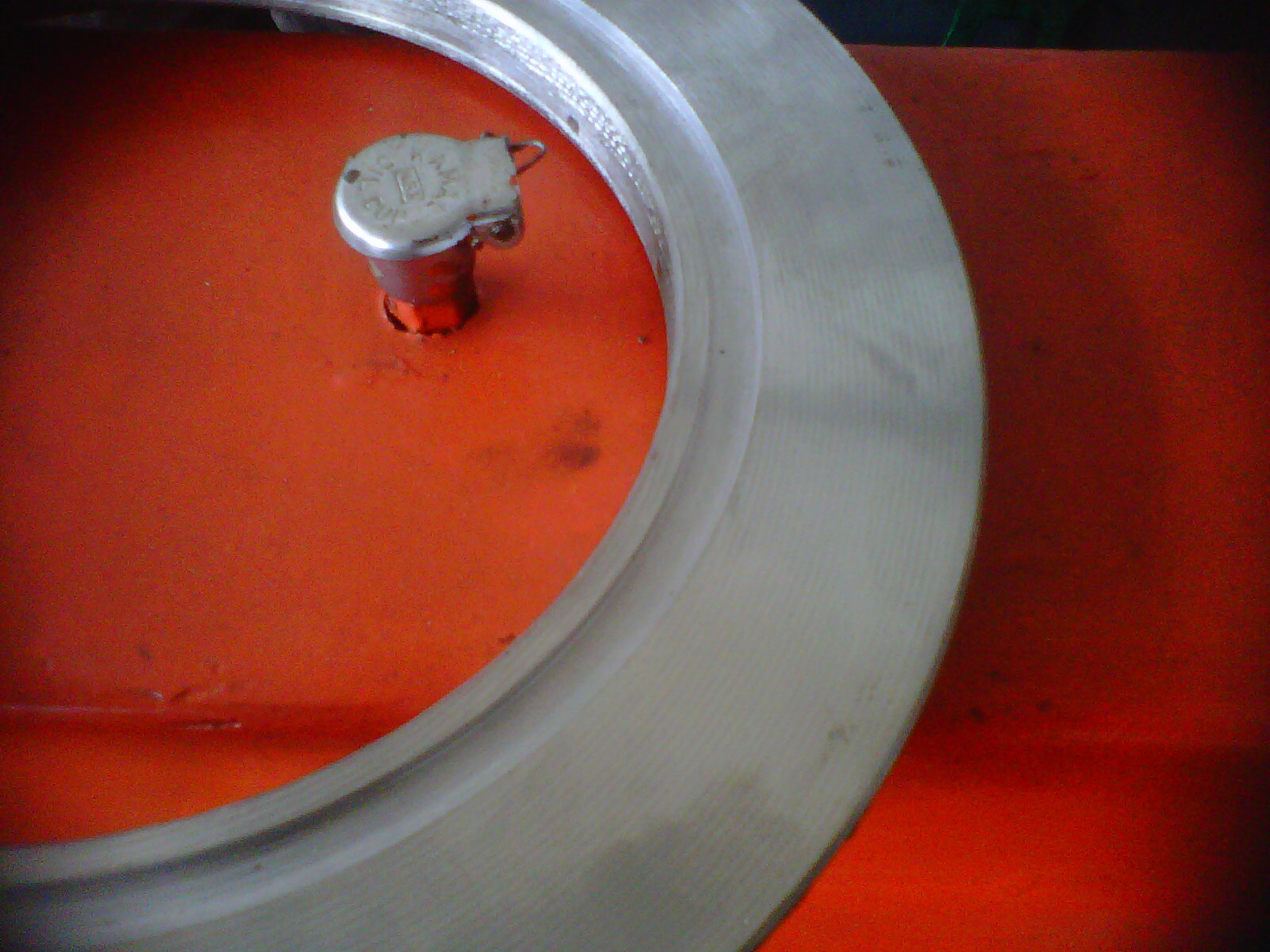

Hello Kris ;Originally posted by Kris3033 View PostDear Friend
Special thanks to Jetijs and Asad and others who have done wonderful task and took lot of pain for our bright future.
Thanks for the complement & I would like to thank our Grand Pa Jetijs again for creating such a wonderful forum .
Jetijs were are you nowadays, haven't heard from you LONG. Are you on a honeymoon ???
Now Kris your preparation is in the right direction & remember
'Sucess never come in one SHOT . You have to try Again & Again & Improvise accordingly.
Answers to your questions.
1) Your output pipe size is ok.
2) Diping pipe in Chilled water should be done , infact i would suggest that place your pipe in an 4"inch-oversize pipe having water inlet & outlet . Hang it vertically & Water coming in from the bottom inlet & the outlet is placed on top of the oversized pipe .
The efficiency of vapor condensing to liquid will double .
3) for removing liquid fuel from condensors you have to place a Gate-Valve at the bottom of the condensor.
remember one thing that for few runs normal gatewall or ball type valves will work but the material they are madeup are not much resistant to high temperature upto 400 celcius . There are special valves for this job U have to hunt for it .
4) Jetijs lid arrangement is very important I would say it is the heart of the reactor . The V-GROOVE male-female arrangement is very important . Double check it . I use to sit with the Lathe machinest & as soon as he says its ready I use to mark the upper lid with chalk & place it back on the lower portion & rotate it to confirm the Vogroove is perfect . I hope U got it, if not than just read these lines to your machinest he will understand it .
4) Your First TEST run should be with plain water only without putting CaoH even your reflux chamber should be empty . I did it to make sure that the unit is working properly.
a) No Vapor leakages specially from the Flange & pipe joints .
b) Heater+temperature control systems working properly .
c) Water vapors are properly condensing.
d) Second trial run you should do with waste motor oil (WMO) only .
Again no CaoH & reflux chamber EMPTY .
You will gain a lot of confidence if you follow this Golden path
When I started experimenting I was jobless for about an year & my first reactor used to catch FIRE as soon i hit the temerature 300 celcius the last fire went so strong it nearly burned my neighbors truck .
There was no one to guide me through I use to ponder whole night what to do next .
Alhamdullilah My 100 gallon baby is running perfectly & Iam getting serious inquiries from many countries to make a unit for them .
Infact I just
signed an Joint-venture Agreement with a Getleman from Dubai to make a reactor for extracting Styrene Monomer from waste plastic .
You are lucky as so many people on this forum are here to guide You .
Wish you all the luck .
