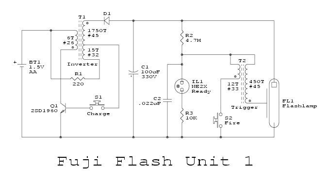

some other transistors that work...
2SC6081, KSD1273 seem to work similar to the fuji camera transistors with slight changes in resistance or capacitance. 2n4401, and even 2n2222 work if you drop the resistance further, but they seem to have a greater power draw and the light cuts out sooner.
