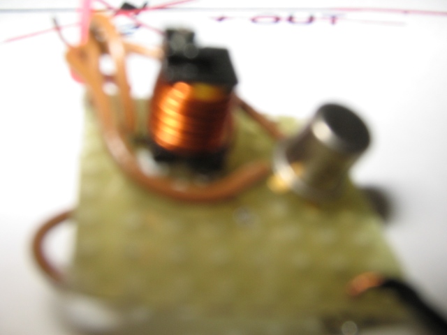

Originally posted by kooler
Bet we could get this to work with a MOT and HV cap @all you can make another transformer that oscillates with the trigger coil by wrapping 8 turns around it and connecting them to the two unused pins on the bottom . Pictured is just that with a 2n2222a . more later ..
