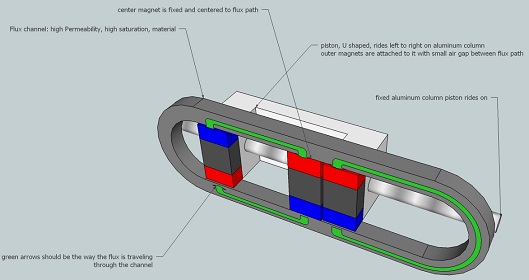

  • Hi, don't post here much but had and idea and would like a little input as I think there are people here with a lot more experience with magnetics. I attached an image of the basics of my idea the ultimate question is: based on the picture will the piston move to the right?Click image for larger version

        • @ Dean2 the thinking is that if magnets are attracted to each other through air once their flux couples why wouldn't they attract if their flux coupled through another media, especially if the media concentrates the flux? The gap between the outer magnets and the channel is small 1mm or less.
          • Hi PhoneBoy, Before we consider those other aspects, from your diagram - the forces appear equal on the left and right. What force is going to cause movement? The balance, or symmetry equals "zero" in force. Please explain.
            • In the diagram the center magnet is fixed, since the piston can move wouldn't the left magnet be attracted to the center magnet, the right magnet's flux would complete through the channel and effectively do nothing.
              • symmetry
                Hi Phoneboy,
                If you build this, I think what you will discover is, your two moving PMs are going to center themselves between the fixed one and the outer frames. Even though you will have a flow of flux through the high permeability material, you still have "balance" of forces. Also, if you notice the flux pattern, most of the energy is going to become confined internally - like a toroid, hence the force between "exposed" poles is going to be smaller as well. I don't mind being wrong, just build it and discover.
