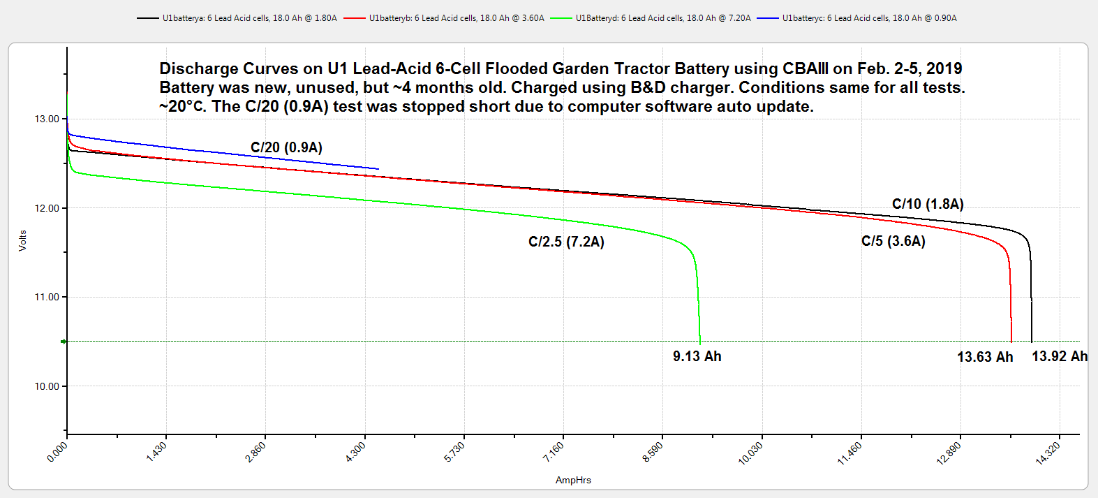

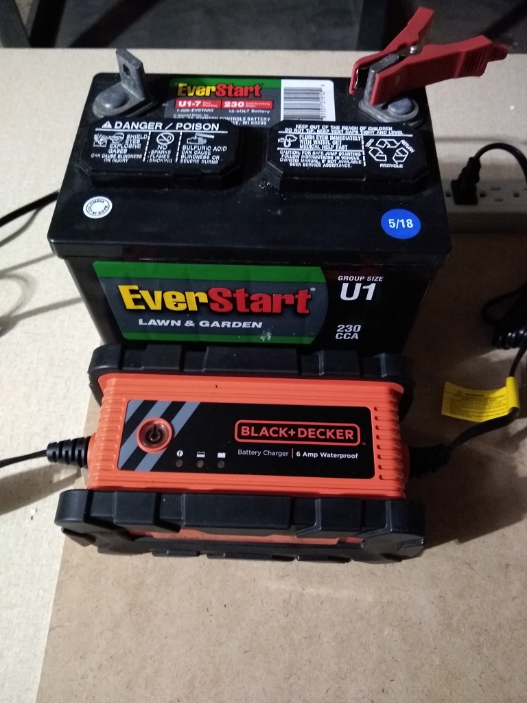

I noticed you are using the EverStart brand U1, 230 CCA FLA batteries. Did you verify these to specifications or other test for capacity when you first got them? I ask because I have noticed something about one I just tested. I'll outline that below. First, a photo of my battery, and the Black & Decker (B&D) charger which I used.
I am using a West Mountain Radio CBA III tester and laptop to log constant current discharge and plot against Ampere-hours. Here is a family of curves at various C-rates. About 7.5A is the limit of the unit. The C/20 was interrupted due to laptop timeout. More on that later.

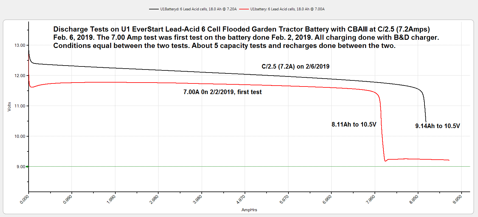

Next is a discharge comparison of the first run on this battery at 7.0A and cut-off set to 9.0V vs a similar run at 7.2A (C/2.5) with cut-off set to 10.5V done 4 days later. Notice a 12.7% increase in charge (Ah) on the later test. Also the the higher voltage for the later test indicates a much lower internal resistance and likely near 20% more energy from the battery under the same conditions and charged the same.

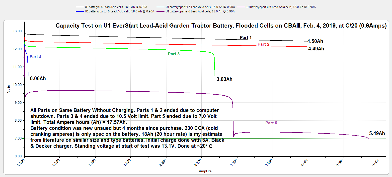

On the above curve, red trace for the 7.0A, notice the line goes horizontal near the end. This prompted me to further investigate when running the C/20 curve by setting a low cut-off. As I mentioned earlier, the length of the 20 hour discharge caused several computer disruptions so I simply started up again renaming part1, part2, etc, without recharging in between the parts. By doing this, the charge (Ah) from the individual parts are additive. Total Ah is 17.57Ah for the 20 hour rate. Although I was unable to find a specification on the EverStart U1, 230CCA battery, similar products appeared to be rated around 18Ah for 20 hours.* {see edit}
These "knees" on the discharge curves indicate a single cell (of the 6-cell battery) giving up. So this battery has one cell good for 12.02Ah, one cell good for ~15.36Ah and 4 cells good for 17.57Ah or more.

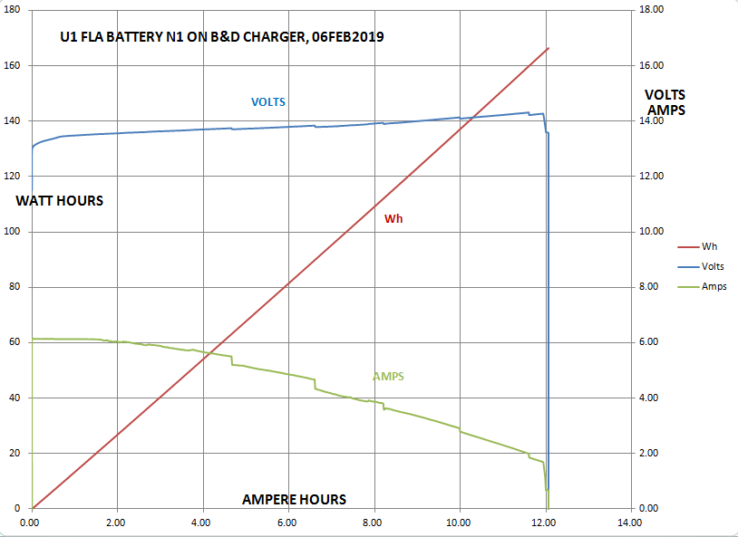

Just for kicks, I used my new instrument to record a partial recharge of this battery after the last test and calculated the Ah and Wh and plotted it. Takes a bit of time to do, but I think will yield some accurate energy data for both charge and discharge. Attached.
{edit of 13Feb2019} With further literature search, group U1 size lead-acid batteries are rated 32 to 35 Ah.Last edited by bistander; 02-13-2019, 08:53 PM.

To tell you the truth, I didn't check anything. At the time I bought them because John was using them and they were about the cheapest. My favorite batteries are Marine deep cycle which are in between start batteries and deep cycle batteries.
To top it off all these batteries have been converted to Alum (no acid). So there's nothing to compare this to. Alum batteries tend to hold their power lower and will be running strong down to 9v (but an inverter has already turned off around 10v), so there are trade-offs. I like them because I can charge them faster and you can't hurt them. I have drained an Alum battery to dead 0, left it with an incandescent light on it (a dead short) over night, and they start recharging them selves as soon as you take the short off. Then they take a charge and work as usual. They don't have a problem with sulfation, in fact one of the best batteries we every had converted had sat on a pile of dead batteries for years and wouldn't take a charge. We converted it, charged it and it held for at least the manufacturer's Ah rating. At any rate, a friend of left some of his Alum batteries out back of his house for two years on the ground in TN where they got snow and everything. After two years, some of them were holding a medium-high charge and tested better Ahs than new. So you can leave them charged or discharged without hurting them. If your running lights or things that are not voltage sensitive, they are great...you can't hurt them.
