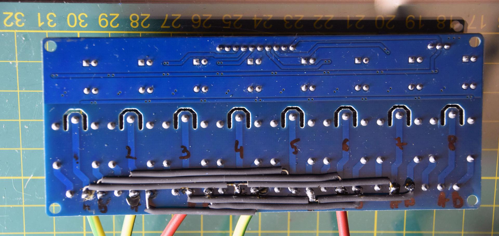

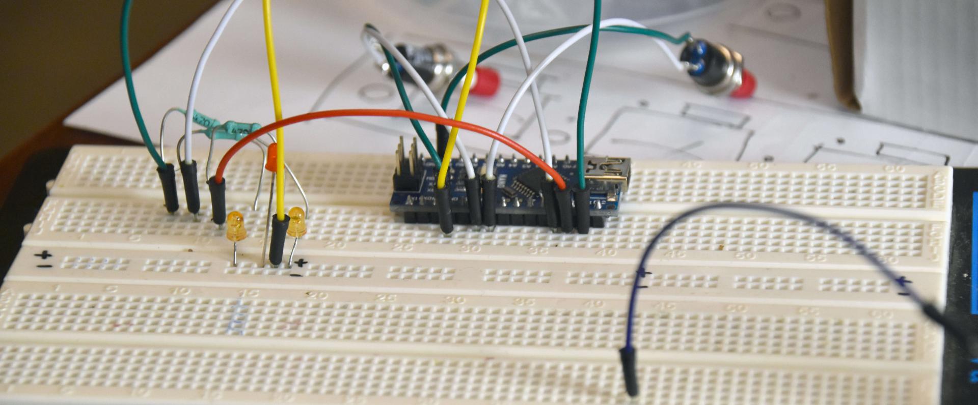

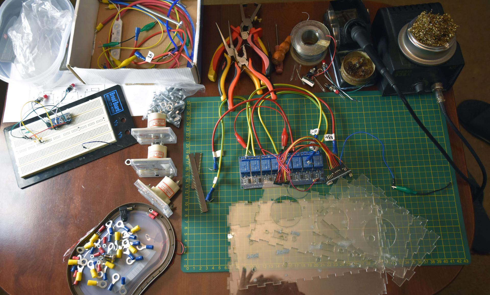

Finally, I have some time for my project, so I will post some updates.
I decided to give a try to 3BGS automatic switch project, though I am aware it will be a long and difficult process. My previous system was with 2 batteries and a boost converter, but after some tests in 3BGS configuration, the results was very encouraging.
First step was to create a semiautomatic system for switching the batteries, using for the beginning 4 push-buttons, which will command Arduino to switch 8 relays (12 volt each, actually 3 relays at the time). I am using now just 3 x 5 Amp batteries, and a fourth battery for Arduino and relays.
Well, this is my first result, as you can see also in the video.
https://youtu.be/9iEPh9Jon1w
The system is working, BUT, in one configuration (Battery 2+Battery 3 charging Battery 1) the polarity of the load is changing, so the + pole become „-”.
The only way I find to solve this is to add another 2, maybe 3 relays, which will increase the current draw to 150 - 180 mA... For bigger setups, up to 60 Amp batteries, I think is worthing this current draw. Later, when the system is set, I can use latching relays, and the current draw will be very low. The total current draw, now, at the arduino + 3 relays ON is between 120 mA (at 12 volts) and 100 mA (at 10 volts).
Unfortunately, because of the common ground issue, I cannot use n-mosfets on lower side, nor p-mosfets for high side, and i don't know other way to switch the batteries with a galvanic isolation.
Any suggestion? Is there other way to reverse polarity using discrete components?
Second step is to find a way to isolate the voltage divider resistor readings for sending to Arduino - I cannot use a common ground for those dividers, because of the different configuration of batteries connections.
I was thinking to use optocouplers... what do you think?
