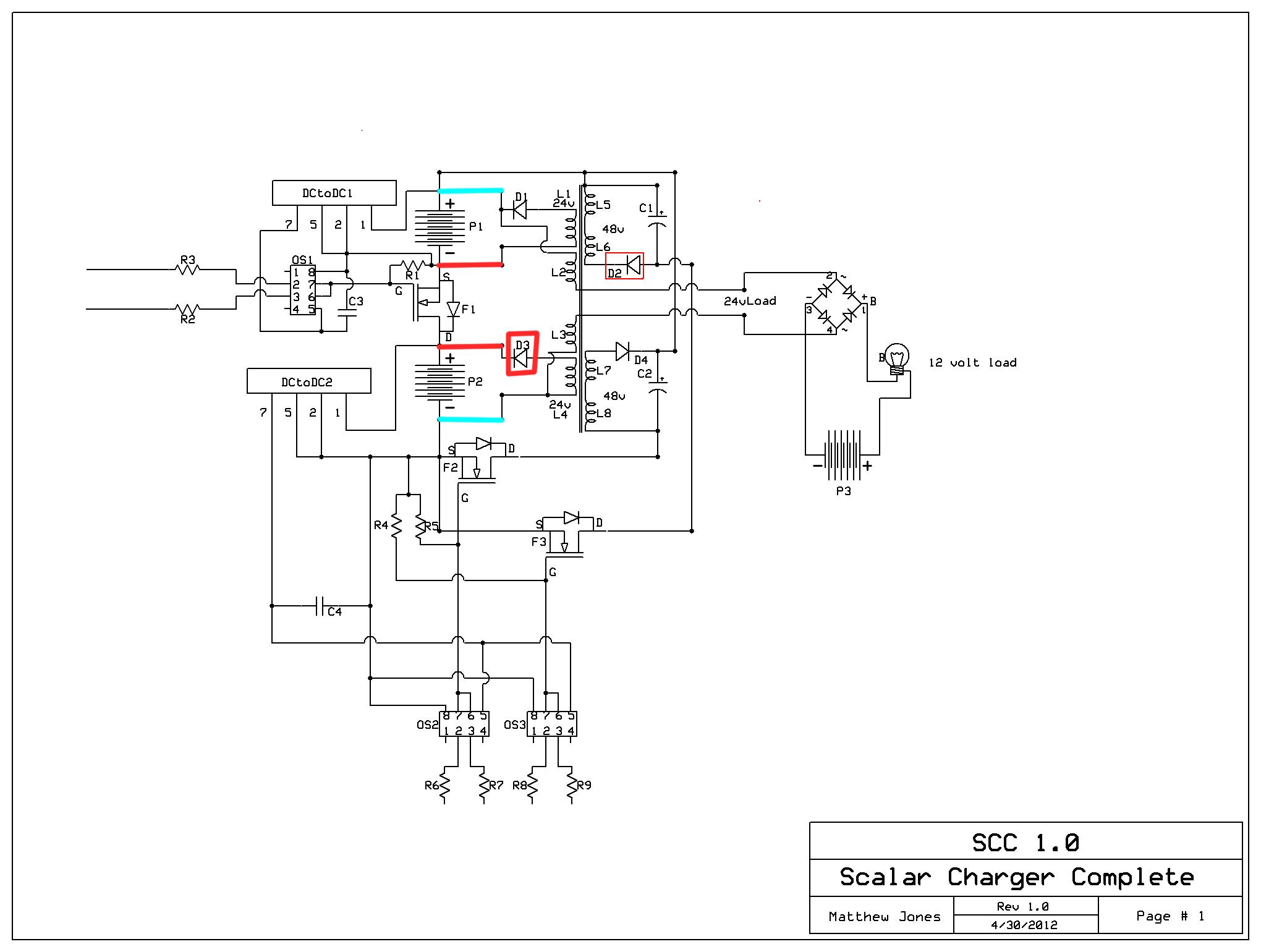

One other thing I would suggest is putting an on/off switch between your stamp and its power supply. If things go South you want to be able to kill the power quick.
The STAMP runs off of a 9 volt battery, or you can hook it to an isolated 12 volt battery as Matt has discussed. If you use the 9 volt you STLL have to have a 12 volt power supply to run your board. If you purchase a snap on battery connector that will snap on where the 9 volt battery was supposed to go, REMEMBER that the RED wire coming off that snap on connector goes to GROUND and the BLACK wire goes to POWER. That connector is made for snapping onto a battery, not IN PLACE of a battery. Look at it carefully and you will see what I mean.
