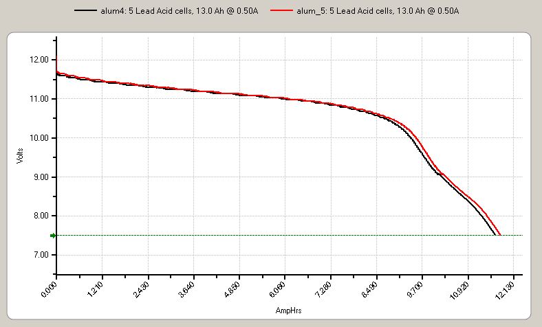

          This is a repost from the Earth Light thread.
          In dec 2007 I purchased a new U1P-7 lawn and tractor battery and dumped the acid mix out. I refilled it with a alum solution (McCormick's Ammonium Aluminum Sulfate and distilled water). I charged and discharged it 5 times using 'West Mountain Radio's Computerized Battery Analyzer (CBA)'. It then sat on a shelf untill sept 2009 when I repeated the tests again. It showed a standing voltage of aprox 11.6volts and the discharge curve continued below where it would if it was a lead acid. I took it off the shelf again and am charging it now to run another round of tests. The pics show charts of the 2007 and 2009 tests.
          The battery has been charged and is on the CBA discharging.

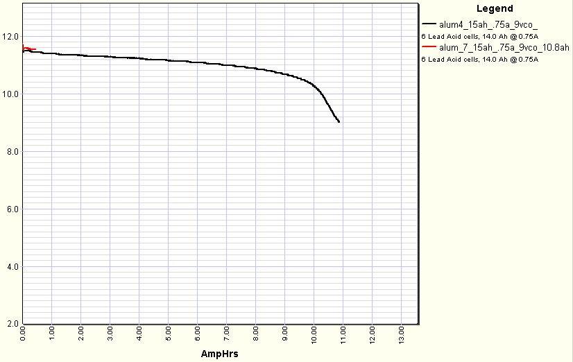

            Thanks for posting this over here. I have 5 Alum batteries here and can run some charts if you want.
            I have taken the batteries out of cars here. I have one other one that has been sitting outside frozen.

              few questions
              Thanks for posting mklimesh
              I have couple of questions to compare with my results:
              - did you use baking soda or just distilled water to flush battery?
              - what ratio alum/water did you use?
              - did you notice anything different (from LAB charging) during each charging, such as time, Amp?
              - how low you're taking it down with a load (resting V after discharging)?
              - what is the highest resting voltage after (charging cycle) you're able to get.

                Flushing: After acid was drained and battery shaken by hand 5 times. Left it upside down on 5 gal bucket for a few hrs (T105) Shaken more. Then used garden hose to flush for about 20 minutes 3 times (Filled let set 20 minutes, drained 3 times and shaken) Let sit for about 24hrs with caps off to help evaporate. Then mixed 2 cups Alum to 1 gallon of distilled water (HOT) until disolved. Then filled battery with hot solution then charged to 15.4Volts (Bedini charger). This only works if you have a semi decent battery to work with. Heavily sulfated/ shorted batteries are useless to try.
                I have converted 10 batteries. If the battery was realy bad to start it stayed that way. If it was semi decent then it worked well.
                Discharges deeper.
                Charges faster then lead acid
                NO CORROSION ON POST.
                Discharge to 10.5 volts
                Resting voltage after charge: 12.4volts roughly
                John is making a video that will address some of these questions he will post in the next day or so. Hope this helps
                Chuck Hupp

                  Thank you John for PM and joining. Yes, definitely, if that's not too much trouble for you I would love to see the charts to compare characteristics and I'm very curious about the frozen one. I don't have battery analyzer at my disposal. I believe I'm not the only one successful with pulse charging and rejuvenating effects in batteries and also believe, that this maybe good way to build efficient battery banks, either as a backup or storage (solar) . They can be discharged much deeper as lead acid (similar to deep cycle) without any harm. Also, I didn't notice any sulfation/degradation of plates. What I saw instead was some sort of crystalline formation which may explain the way they behave. I left some of my stuff behind when moved (despite pulling 53" trailer ) and most batteries "didn't catch the bus".

                    Thank you Chuck This is very valuable feedback and much appreciated. I also noticed no corrosion on either of posts, faster charging and sitting a bit lower than LAB, which fooled me at first conversion attempt and resulted in wrong conclusion.
