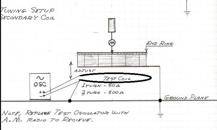

      • Tuning of secondary coil
        Originally posted by T-rex View Post
        ..... Finally, the secondary is made to be operated with a large external tuning condenser such as 2 six inch disks with variable spacing, or a large transmitting neutralizing condenser.
        Hi Eric:
        I will redo the testing as per you instruction. What I did so far was based on the procedures described in post #181 of 4/9/12. For the "Tuning setup - secondary coil" I did not notice any tuning condenser, so where do I connect it? Also I will connect the Function Generator + and - together as shown in the posting and connect the negative of the "Field intensity meter" to the ground plane. Also, is the secondary's end ring connected to the top of the secondary coil for this test?

          • Testing
            Originally posted by Nhopa View Post
            Hi Eric:
            Also I will connect the Function Generator + and - together as shown in the posting...
            Well, I tried to connect the Function Generator output to it's own ground, as shown in post #181 of 4/9/12, but as expected this kills the signal. So what is the correct hook-up?
            • Originally posted by Nhopa View Post
              I think it should look like this. I tilted the one loop test coil a little bit so you can see the connections better but it should be orientated like the secondary.
              • Thank you jake, this will work, but I still don't know where to hook-up the large adjustable capacitor and should the 1/4" dia copper end ring tied to the upper end of the secondary coil. The difference in reading is about 400 Kc.

                  • Secondary Tuning
                    The oscillators I used were large Navy exciters but a solid state version may need more turns of finer wire like #22 and 6 turns. The copper end rings are the capacitor to start with. The secondary high lead connects to the bottom ring and the neutral lead connects to the top ring. A sheet of glass can separate the two, sandwiched between top and bottom rings.
                    73 DE N6KPH
                      Yes. The 1/4" copper ring needs to be connected to the top of the secondary. It essentially becomes the final turn of the secondary.
                      Do not know about the neutralizing condenser. I was under the impression that the secondary served as both inductor and condenser.
                      When u add the primary with capacitor it will drop the frequency of the primary/secondary setup. It will get you close to your calculated freq. At that point you would add the extra coil. Then your beating me cuz I ain't there yet.
                      Good luck
                          One plate connects to top of secondary, and the other plate connects to bottom of secondary.
