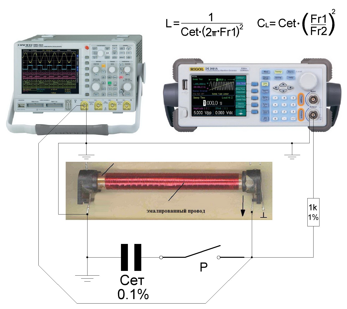

        • Capacitance measurements
          Serg V:
          Roughly what size reference capacitor do you recommend?

                  • Originally posted by Nhopa View Post
                    Serg V:
                    Take a bunch of different size high quality standard capacitors with min tolerance +-0.5%.
