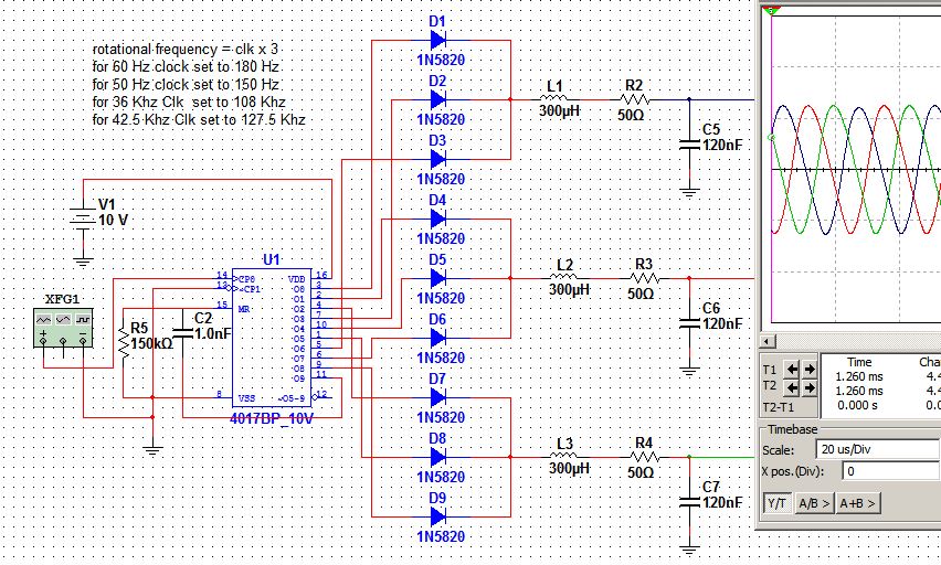

The purpose of the 3 phase oscillator is make a sequential signal to drive mosfets with high voltage into Tesla coils. The idea is to build a field above an Alexanderson Antenna sequentially. The oscillator for below is synchronous but not sine. I do not understand how this can be done and Eric Dollard would need to explain. I don't understand difference in Alexanderson's generator ? a solid disk ? reluctance alternator ?

It is entirely possible to change the frequency (22.1 Khz) of the 4017 3 phase oscillator. see attached photo below.

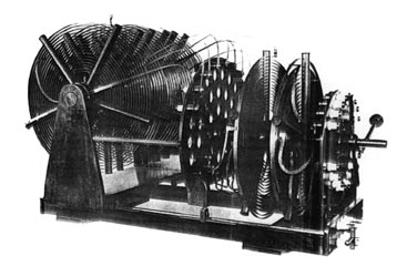

I believe this photo of Tesla final output section for radio transmitter used for naval communication. There are 6 flat coils from 2 or into 2 ?
I think about this as 2 cascading 3 phase. He probably wired the generator for 6. The speed of alternators today are a little faster.
