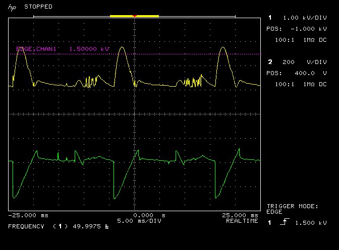

                What is the frequency content of those portions of the waveform which are active during the negative resistance portion of the experiment? If I consider the following oscilloscope trace of the demonstration, I see a slew rate of something approaching 1.5kV/ms:
                Since the effects seem to happen when the voltage is changing rapidly with respect to time, I'm not sure I would discount AC impedance effects entirely. Comparing the above oscilloscope trace to the short-circuit case, it could even be that the main increases in area under the curve occur precisely at those points where the voltage is changing most rapidly:
                Unfortunately the given data do not permit me to evaluate whether the crucial parts of the curve occur above the 10MHz upper bound you used for your impedance measurements.
                Much has been discussed about the novelties of many spark gaps in series, as in the Steinmetz chapter on lightning arrestors which Eric Dollard has posted here repeatedly and which seems to have been an inspiration for Eric's longitudinal research.
                With respect to the phenomena you have demonstrated with this experiment, what effect do you expect to see from multiple CSGs in series?
