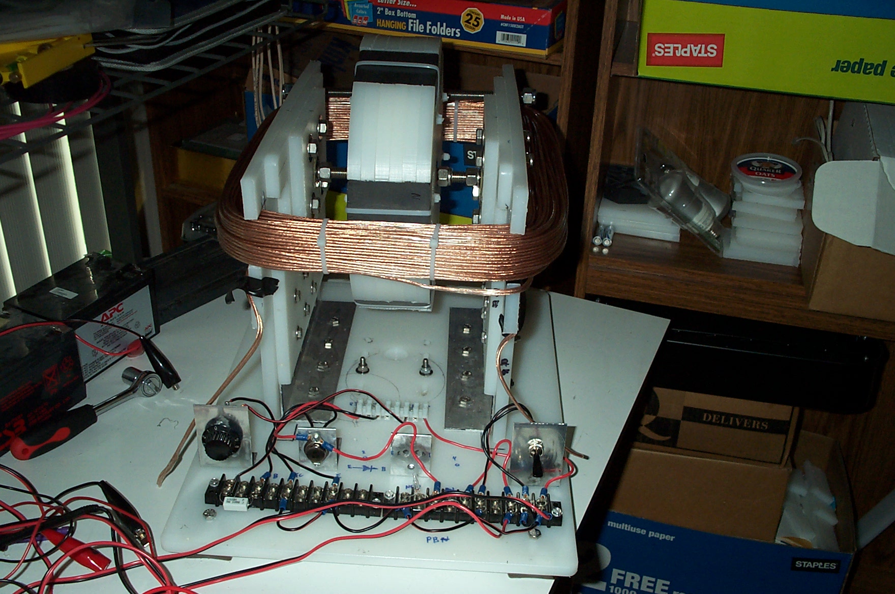

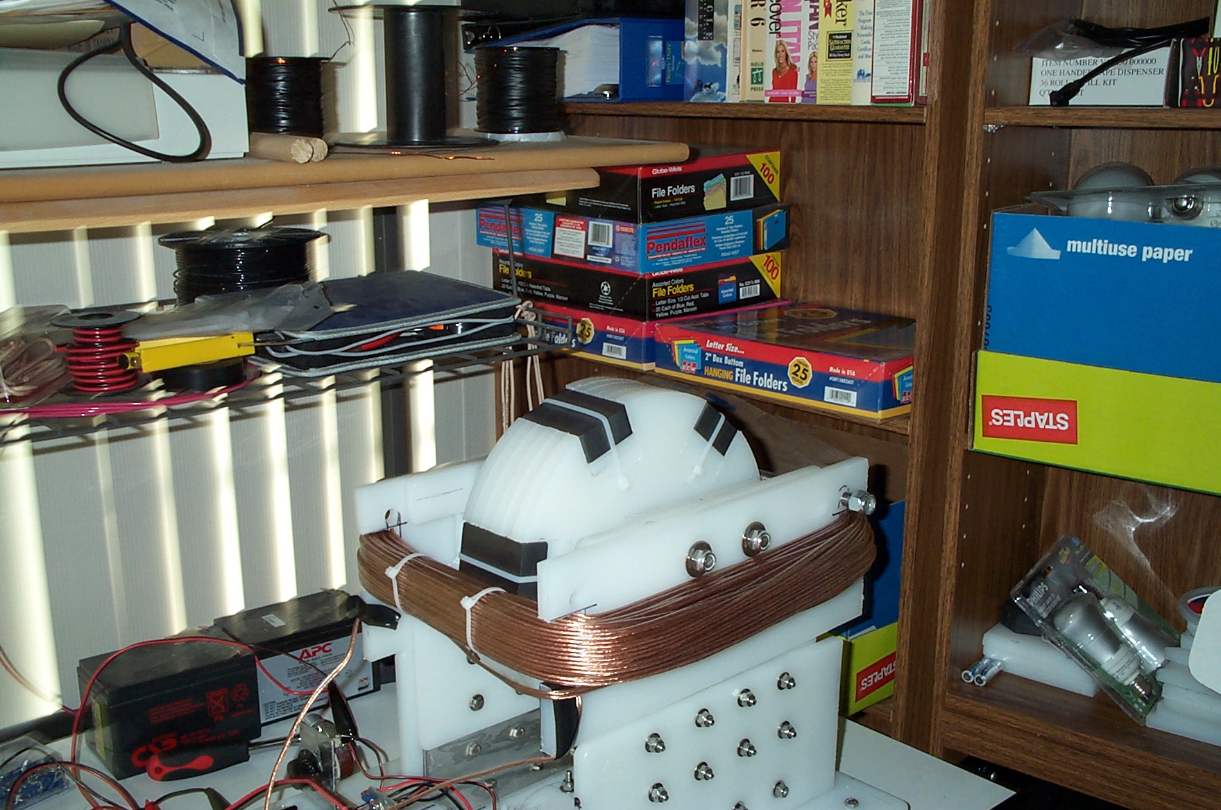

                            • My crazy Bedini replication platform.....
                              This is a couple of pictures of my Bedini platform in window motor configuration..... I am testing out different windings with the SSG circuit...
                              Is free energy green?
                              Tj
                              • Nice TJ.
                                Im not sure if you have enough bolts holding it however
                                No seriously, that aint coming apart there anytime soon. What is the plastic you used?
                                Good to see someone else having a go.
