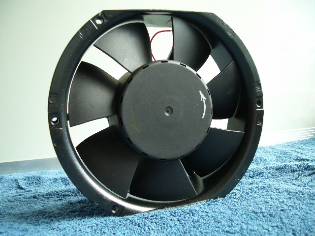

                  Did you test it with a wall power supply to see how much it draws? It is good to test there to get an idea... first..
                  Where did you get your 6 " fan? Sounds idea...

                      Draw
                      Mart,
                      The fan draws .420 ma wall power.
                      My 9ah LA ATV battery is conditioning.
                      Charges from 12.5v to 13.5 in 12 hours, draws down in about 12 hours using 60 ohms.
                      Charge time is getting shorter and draw down is getting longer. :-)

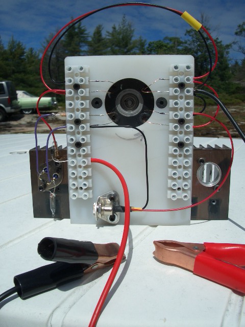

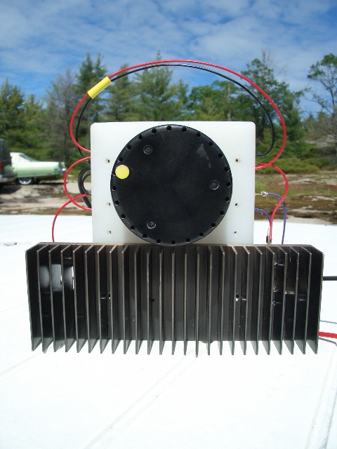

                            SSG get energy from the source in pulses, and so send energy to target in pulses, my first run in my Bedini, ran very well with 12 volts power source regulated, but when I tried feed it with 9 volts batt, don't worked, then I put two 9 volts batts in series and ran slow, but when I added a big capacitor with batts in series, ran very well and fast. drawing 200 ma only. Then you SSG need a minimum voltage to run and minimum amperage to get the source, for get to work with solar cells you need a big capacitor to feed your SSG when work you must tune it again. Another form is converting your solar cells in a power source, for example if you get 22 volts in full sunlight, and 10 volts in foggy day, you can use a voltage regulator 9 volts, with high capacity capacitor, then you can tune it well to work using 9 volts.
                            I used a capacitor electrolytic polarized 220uf x 200 volts. in paralel with source, Capacitor is get charged, and keep a reserved good energy to feed coil in precise moment that is needed.

                              Thank you Patmac,
                              It is working just as you describe.
                              The sun is now running my SSG up here in Canada.
                              Do you have a schematic for voltage regulation?
                              Carl
