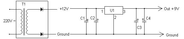

    This is a simple schematics for get 9 volts for example in way stable. You can get 12 volts changing 7809 by 7812 for example, or 7824 for 24 volts, series 78XX is very wide.
    C1 1 1000uF 25V Capacitor Elec
    C2 1 10uF 25V Capacitor Elec
    C3 1 1uF 15V Capacitor Elec
    C4 1 0.1uF 15V Capacitor Elec
    U1 1 Regulator chip 7809
    T1 1 TRansformer 12V, Cell in your case.
    This are the rules:
    7809 like this support 1000 ma max using heat dissipation, output is 9 volts but, input must be 12 volts min for get 9 volts in the output with good stability, you get 9 volts very stable in voltage and amperage. But if input is 22 volts for example output is very stable in 9 volts. Input max is 35 volts aprox.
    7812 obviuously need about 15 volts to sustain 12 volts in output.
    There are others ways to get output stable like zener diodes, but need to know some about electrics deeply and can be problematic because cells vary too much.
    Last option can be by using battery, battery is kept charged with cells and you get energy from battery, the problem is build a charger control for the battery because charged so much can to explode, and discharged so much get damage. Obviously the way more indicated is yours, only with cells run your SSG it's GREAT. And recharge battery very efficientely without use a source battery is better.
    Good luck.
