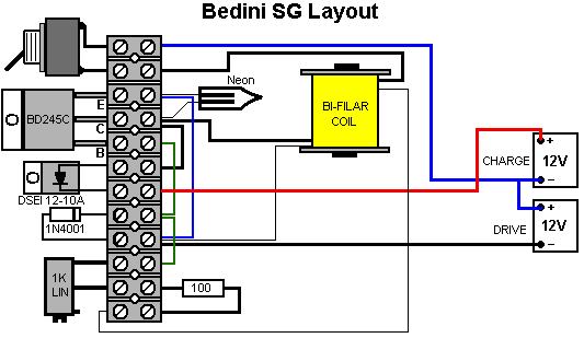

        • Kebob,
          This is a circuit diagram I used for my first ssg
          • ok well this is due onmonday so i might just solder it. also what wires should i use to connect the wire from the negative of the battery to to the emitter of the transister since the diagram dosent tell

                  • Ok so i got it setup but it didnt work. i think its becuase i used pvc to make the coil so i am changeing that now so that its just the wleding rods in the middle with the wire wrapped around it. is this alright?

                        well it seemed to be becuase i believe i soldered right and we had enough magnet wire. but is it ok to wrap the magnet wire around the wleding rods?
                        • Originally posted by Kebob View Post
                          No, this isn't a problem
                          . Why do you think it may not work because of pvc? Did you have a chance to see other people videos of their projects? All coils are wound onto spools, either wooden or plastic. As long as they are not metal. Do you have a spool or just piece of PVC pipe with no ends? How long are your wires? Can you post a picture of your project?
                          There are few possible reasons for not working but I need to know more details to help you diagnose.
