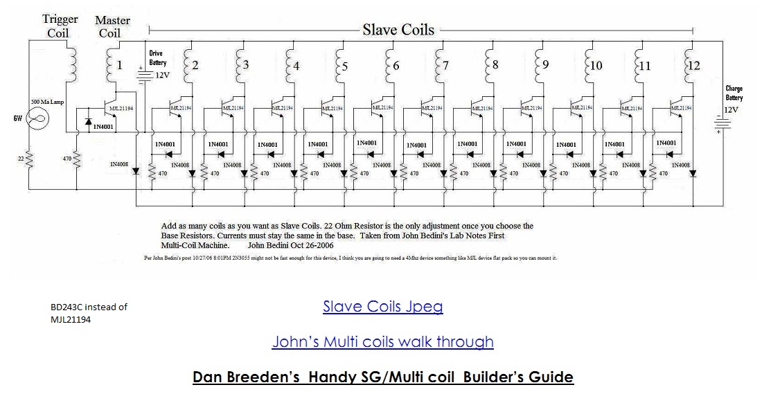

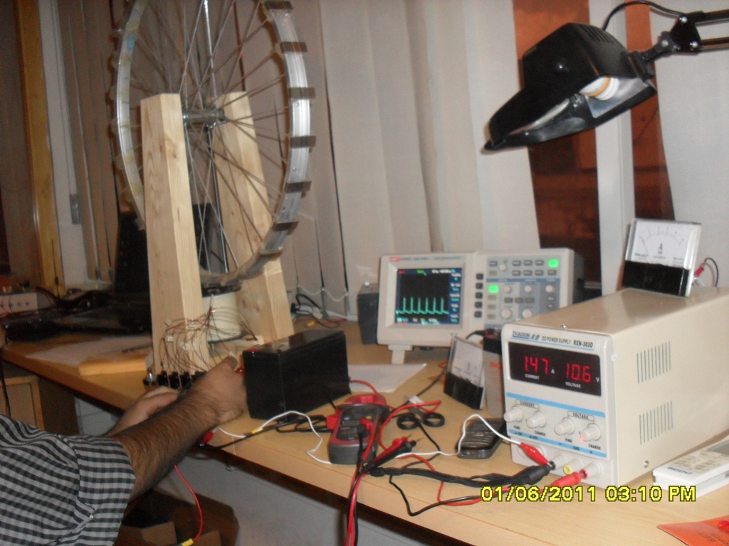

                            Hi,
                            I just made bedini multi coil circuit. I made 8 power coils.
                            trigger coil adjustable resistance is 20 ohm.
                            Schematic is attached.
                            I used BDC243C transistor.

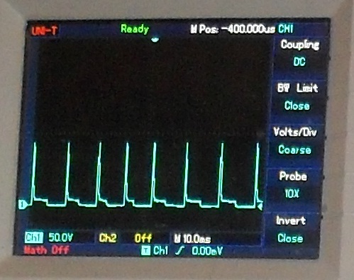

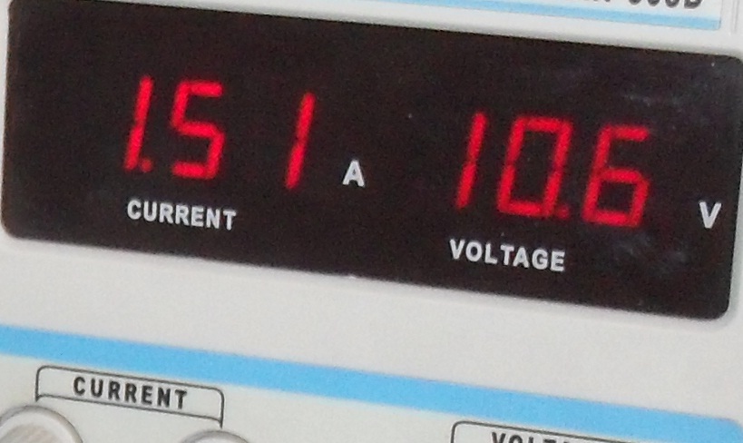

                            I got about 150V peak at ouput, approx 1.45~1.55A input current.
                            The current to 12V,5.4Ahr battery was about 0.55~0.65A.
                            When i disconnected the battery(i have attached neon bulb for safety), the input current started to increase and so is the rpm of wheel.
                            But when i connected the battery rpm was slow. Just input current was greater
                            if we compare it with single coil SG.
                            Any suggestions... to improve rpm and charging rate.
                            I haven't yet tested the charging rate for this multi coil SG. I will update that soon.
                            Salman.

                              Hi Salman,
                              your currents look about right. I like your build it looks clean and solid
                              what are your coil specs? wire length, awg, core, etc...
                              what is your RPM?
                              are your magnets ceramic?
                              in the scope shot, why are some of your on times longer than others?
                              the neon's will not always protect your transistors, they are meant as training wheels, I would not disconnect the charge battery.
                              do you have your power supply connected directly to the energizer input?
                              you should at least put a large cap in between.
                              if you want better charging you should use a large/huge LAB on the front end. One that will take your 1.5Amp (preferably 2amp) at a C20 discharge rate.
                              JB offers a ton of info in his posts here on this old forum:
                              Bedini_SG : Bedini SG Discussion List
                              search his posts
                              Patrick

                                Coil specs: trigger coil AWG#26 , All 8 power coils AWG#23
                                Wire length : about 450 turns each
                                Magnets are ceramic.
                                "why are some of your on times longer than others?"
                                Well i don't know the exact reason yet.
                                Yes power supply is directly connected to energizer.
                                "you should use a large/huge LAB on the front end."
                                I didn't get that ..............LAB??
                                I think i need to tune my circuit a little..
