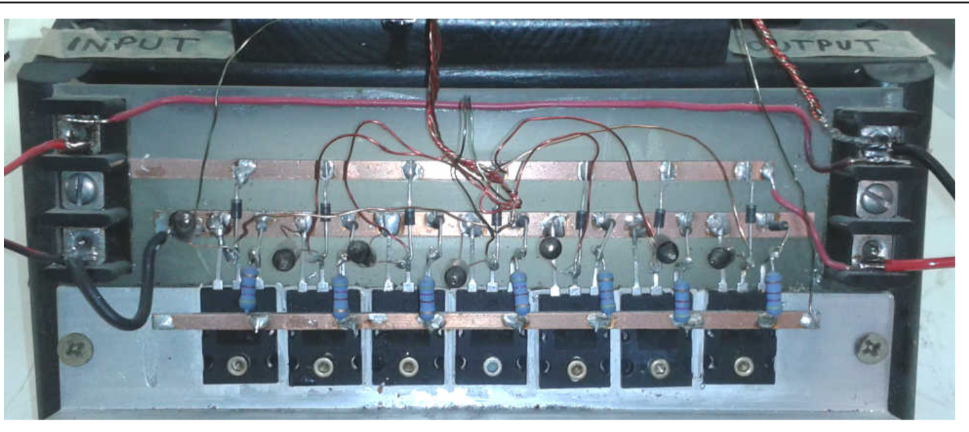

                Looking at the photo of John's machine, I'm thinking of cutting a flat plastic lid or similar to attach the copper strips to - that the majority of the non-transistor parts are soldered too. Copper strips are not available locally, though I could probably get them if it's important, but I'm thinking of cutting open a copper tube, flattening it out and super gluing or hot gluing it to the plastic backing. Will that work? If so, is it better that the copper strips be thick (the walls of the tube are an 1/8" or so thick), or should I try to thin them out (I'd probably use a grinder and/or sander)?
                    The thicker metal could make it a little challenging to solder, but other than that you should be fine. Also i don't think a foot of wire one way or the other will keep you from a successful build.

                          • It's the image from page 62 of the beginner's handbook. I was unable to complete the upload (the window freezes on me after uploading it from my computer. I'm using the Brave browser, which may be the issue).
                            Having had more time to think about it, I probably answered my first question, which put in another way was whether the copper strip can touch the transisitors without causing damage. I suspect it can given that the transistors are insulated. If this is correct, I imagine I may even be able to glue the copper strip to the transistors. Please let me know if that's correct.
                            My other question of whether you have advice about the best way to assemble this circuit remains (e.g. attach the transistors to the heatsink first, then x, y, z).
                            I've watched most of the video of Peter assembling the kit, and noticed that he adds an additional resistor (10w 12 ohm) to the circuit. Should I do that too?
                            He also says since the instructions are now for constructing the SG in the attraction mode, a heatsink is no longer necessary. This is surely a minor detail, but should I put one in just in case or just make the whole backing piece for the circuit out of plastic (or thin plywood?)?

                              I'm using the photo of John's circuit as my guide (it's attached to my last post), and I can't tell how the transistors are attached to the heatsink. Can anyone clue me in on this?
                                Little cap screws
