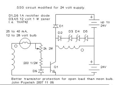

Ok, I got it to sorta work. Solid State Infinite Power Supply (IPS) from Ossie Calla
I built it exactly as the diagram has, except I am using a relay to protect my reed switch.
I am unable to get the coil to trigger the reed switch ( so far )... but moving the reed switch to the magnets it does move like a regular pulse motor
One note my transistor is getting extremely hot..... I may be putting on a heat sync. I wish I had some point of reference to know what I am doing wrong to get the reed switch to trigger on the coil.
Think I will take a break, but anyone who has done this before, would be glad to get your insights.

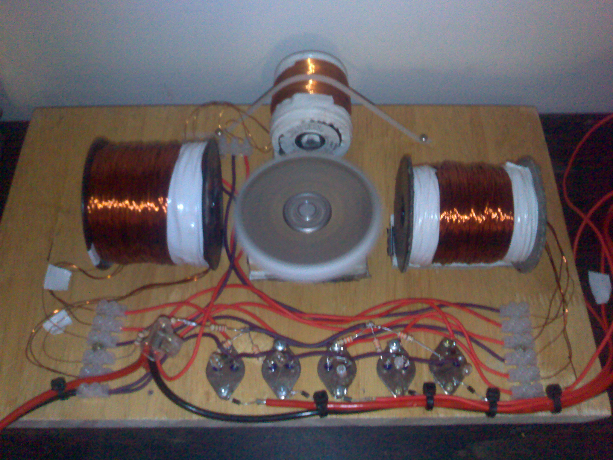

I just completed my dual Coil as well!!!! got quit a few good shocks working on it though. For some reason my second transistor was getting very hot couldn't figure it out it was running and everything was hooked up correctly
Switched out my diode from 1N914 to 1N4001 no change than it dawned on me it only got hot when I hooked up the coil to the collector but it is a pretty small coil only 120 turns of bifillar 18awg not very much resistance . So I put a 10ohm 10W resistor on it and it its working fine now resistor gets hot not the transistor. I was thinking I would try to go lower till the transistor just barley gets warm and stop their I want as much of that precious radiant energy to get back to my battery. The RPM's are also much faster now and when I hooked up my 2 12Volts in series for a nice 24V she took off! however I have not yet figured out how to measure my amp draw, I have a multimeter but which wires or poles do I hook it up to? Also why would my second transistor get hot but not the first one
, because I am planning to make my SSG a Tri coiler and then Six coiler with nine magnets. Charging with a one coil SSG is frustrating and takes time, also treating dead batteries seems impossible. You certainly encouraged me making it a big energizer. My plan is to gradually prepare myself go off the grid.
I am going back to my multi coil setup.
