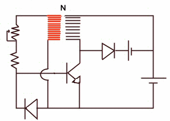

  • ok... well this is how I see the circuit working now... sorry for the poor animation.
    At the start of the animation we see the current in the trigger coil being induced by the north of the magnet on the rotor as it starts moving away from the stator. This triggers the transistor and the radiant event occurs by creating the dipole between the positive and the negative of the primary battery.
    This radiant event pushes the magnet away (thus converting the radiant into kinetic) and then the current from the primary battery kills the dipole (and contributes to propelling the magnet). the original magnet has now left the stator so there is an idle period then the next magnet comes in.
    as this magnet approaches the stator (propelled by the energy from the last radiant event) it induces a current in the power coil that flows through the charging battery (thus charging it).
    Because the battery is creating resistance in the circuit it slows down the approaching magnet as it's kinetic is then being converted to chemical within the battery.
    I think that because the magnet has slowed down more current is required from the primary battery to help propel the magnet again (though the radiant is doing most of the work here).
    When I removed the charging battery there was no resistance in the circuit so the current was free to flow through that point and didnt signifcantly decelerate the rotor so less current was required to keep it rotating.
    at least that is my theory! I wish John would explain things better but I understand why he doesnt!
    I'm not sure if this is what is actually happening but it is the only explanation I can think of right now! there certainly seems to be alot more to it like can the induced current really light a neon bulb?! More study is needed!
    In fact this is probably just plain wrong and I've wasted your time! I'm sorry!

      Hi,
      Thanks for the animation, but I don't think that the induced voltage by the magnet is capable of charging the secondary battery unless the charging battery's voltage is lower than the induced voltage. It is the back-emf which Peter talks about and opposes the applied potential, and is always "less than" the applied potential, because otherwise the motor could not operate at all. As the speed of the motor increases the induced potential increases in the coil, thus the back-emf increases and also the current to the trigger coil increases too.
      What is the H-wave? The h-wave's handle is the spike being absorbed by the charging battery and the rest of it is the induced voltage by the magnet, which if it were more than the voltage of the charging battery that one would be absorbed by it too.
      Only in the case which the charging battery is less in voltage compared to the induced voltage it will get affected.
      Elias

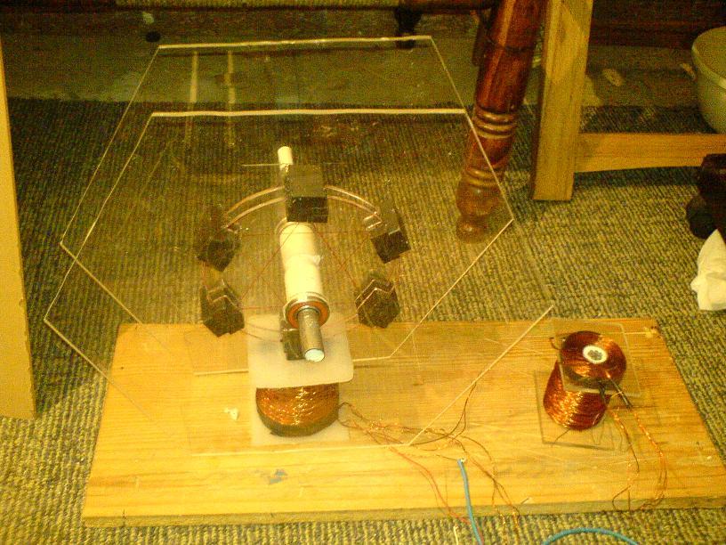

            Hello friends,
            I am about to replicate an SSG with more multi-coils, but after winding one of my coils and testing to see how it works, I was so disappointed, because, the wheel hardly had any torque to it and ran at about 100-150 RPM, very slowly, and more worst of all, it drew about 300mA. Can anyone offer me any clue why this happens.
            My coil has about 800 turns of 2*#28, 2*#21, 1* #19 wires.
            I personally think that it maybe because of my stacked magnets which are too strong. But I am not sure, in this case I should build another rotor.
            A picture of it is attached.
            Thanks,

              I do not have any idea why your SSG behaves like this, but I must say, that I doubt that this is because of too strong magnets. When I double stacked my magnets, I noticed serious increase in torque. Are your bearings good? How long does the wheel spin by itself when you rotate it with your hand? Try to run the system on 24v on each side, this will increase the speed and thus decrease the current draw. What is your core material?

                Why not just remove the second magnets from the stack and run it with single magnets, as a test? And I see you double stack them, one on top the other, rather than making the "scalar north" setup, one next to the other?
                Also, have you considered using more than one coil, one for trigger/drive and the rest for the power, the way JB does it?

                  Jetijs, my wheel does not free wheel so much, but it is because of its small rotor, The bearings are fine.
                  I think that the impedance of my wire is low (about 1 ohm), because when I put two of it filers series, the RPM increased (about 300RPM), and the current draw dropped to about 175mA. I wonder if this is normal. Maybe it is wiser to use a larger wheel.
                  Amigo,
                  I am going to do exactly that, Ill' wind a separate coil for the trigger, thanks. My magnets are glued together, and cannot be removed unless I break them .
                  Thanks Again,

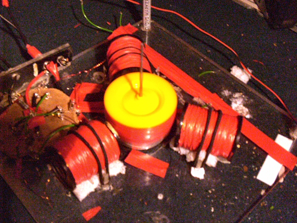

                          I'm guessing it would need enough torque to get it to the optimal speed but any more torque would be wasted energy no?
                          This has always puzzled me. Bedini says weaker magnets are best but HOW weak?! lol...
                          of course you are going to need enough torque to get the motor to it's optimal speed.
                          Amount of torque needed would probably be related to the amount of reistance in the bearings and air resistance...
                          My rotor has very little air resistance since the magnets are recessed... though if my magnets werent recessed I guess I would need a bit more torque to get it to the optimal speed.
                          Though here is another thought! If we use stronger magnets won't they be more attracted to the core and so more energy will be required to create a magnetic field stong enough to break that attraction and repel the magnets?
                          I have a feeling there must be an optimal balance. At the moment I am using 10mm x 20mm x 5mm magnets and they seems to work fine with a 1000 turn trigger coil (though it's a bugger to start up!).
                          Anyone have any thoughts on this?
