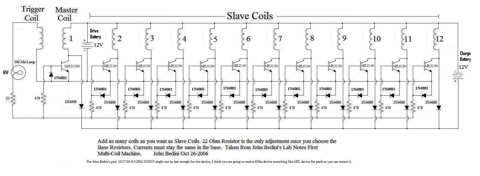

I have a 680ohm resistor between the trigger wire and the base, maybe thats to much for my setup. Originally I had a 1K pot and when turned all the way up the noise got louder and would eventually stop the rotor. I also have only 435 turns on my coil which is kinda low I would like to get 800 turns, im not sure how that would affect the self oscillations though. any tips would be appreciated!
amazing the variations you can do with this.
