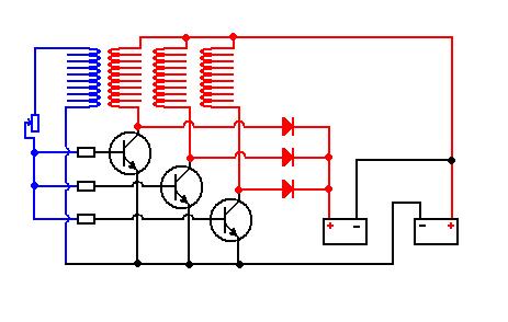

jetijs, I have been having trouble hooking up more than one transistor to a single trigger. I think from your picture it looks like all transistor emitter terminals are linked together. Do bases simply have appropriate resistors and are they all linked together? I have found some schematics for wiring up multiple transistors and havent been able to follow them properly. Im more of a visual learner...

Yes ren,
There was a difference. I could get more RPM's if I had a transistor for each strand or the coil instead of only one transistor for all the coils in parallel. I do not know why this is so. Of course there is an improvement in RPM also in one transistor/parallel coil setup, but not as big.It's better to wear off by working than to rust by doing nothing.

Hi guys,
i've been playing with a bedini motor for about 4 months now but now I'm having trouble adding a second coil to the curcuit... for some reason I can't find any schematic for it online...
I had it running fine with a second power coil hooked in series with the original bifilar coil and that worked fine but now i've made a second bedini curcuit + coil that I'm trying to hook up but when both are connected it seems to short out the batteries... I must be missing something...
can anyone help?

Sephiroth,
look some posts above, i posted a circuit for multiple (in that case three) coils on SSG. Just make sure that your other power coil is aligned 180 or 90 degree apart from the primary coil if you are using 4,6,8,12... ect. magnets. So that when one magnet is on top dead center of primary coil, there must also be a magnet on the top dead center of your slave coil.It's better to wear off by working than to rust by doing nothing.

I think so. Basically each power coil needs to have its own transistor. But all the transistors are triggered from the one trigger coil. You will need a higher wattage pot in order to use more than 2 transistors.It's better to wear off by working than to rust by doing nothing.
