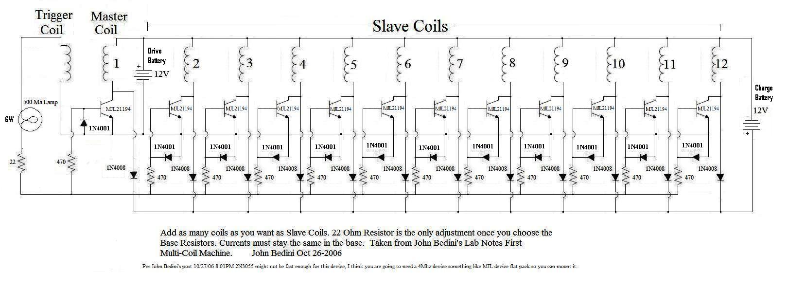

                        Ren here is a schematic I found from Bedini himself however I only see one transistor per coil! I too have my dual coil SG setup in a slave configuration one coil triggers both coils to fire simultaneously seems to work well just haven't got around to tunning it yet. In those pictures he has 4 transistors per coil that is what confused me the schematic I have only requires one per coil. Good point on the mass for the fly wheel, once it gets moving it would have allot more torque!
                        • I think that the schematic is simply drawn like that for simplicity. The slave coils can be separate coils or they can be multiple windings on one coil. By the look of JB's pics he has 4 transistors in a row per board, so he probably has 4 filar coils, meaning each coil has 4 lengths of wire. However one of them (the master) would be 5 filar to accomodate the trigger winding.

                            Ahhhh so each wire has a separate transistor! I have a bifilar on my second coil but hooked up my one transistor to both wires. I wonder does having multiple transistors per coil increase the E-effect ( environmental energy amplification). In my opinion whatever John bedini does is worth trying since he is the father of these motors anyways.
                            • yep you got it! Split yours and run two transistors, using the signal from your trigger to activate the second transistor. You can have a switch for each transistor, so you can run on one and note the differences when the second is off/on.
