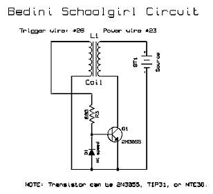

            • schematic is good
              That schematic is fine as it is...that would be the bare basic SG and is the starting point.
              The diode leaving the collector is just to send the collapsed spikes to a recovery battery or cap, etc...
              You don't need that for it to run...the schematic you posted is perfect.

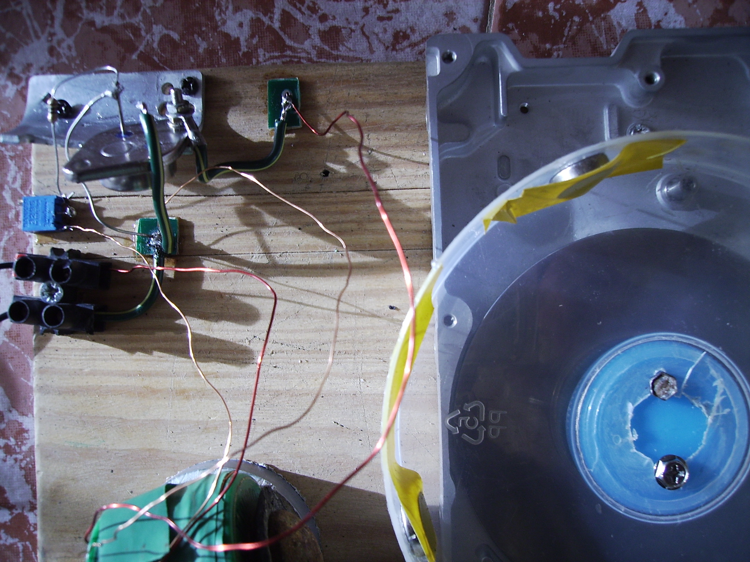

              In your pic, what is that blue thing ahead of the resistor going to base?
              Also, you probably have it right, but make sure you don't have the Base pin and Emitter pin on the transistor backwards.
              • The blue thing is a variable resistance, which at the moment I've got set to zero with the fixed resistor at ten ohms. If I bridge that resistor with the meter on 1 ohm test, with the positive probe to the right, the coil begins to oscillate and with a compass behind the coil, the rear of the coil starts to show south. If I do this without the core in, I only need to give it a quick touch and then it continues oscillating and when I jack up the resistance, the whine rises in pitch.

                  Here's another pic from above, in case it helps.

                      What are you using for a coil spool? Almost looks like a green skate wheel. Probably not with that many turns...for a core, it should be pretty close to the inner turns of the coil...if there is too much material gap between core outside and inner turns, there might not be enough induced current at the coil.
                      • Aarons right, try moving your coil closer to the rotor, and make sure theres not too much gap between core and windings. Also, if your a visual person like me you'll find this diagram easy to follow. The 2n3055 to3 transistor is mounted upside down inside the heatsink with the prong (base and emitter) sticking out.

                            The coil spool is a plastic spool, originally for solder, with an inner diameter of about 2 cm. I've tried various things in the core, first a cluster of thinner steel bolts, then a piece of cast iron and now the fattest bolt I could find, which is quite a bit thinner than the spool core but has a quite wide head and nut.
                            The 2n3055 is connected with the base on the left and the emitter on the right with the transistor on its back and legs in the air (!) with the pins above the centre line.
                            I've tested (and tried bridging) the variable resistor.
                            I've tried about every gap position I can think of.
                            Later I'll try it in the car, just to eliminate battery possibilities.
                            • Re. Diode query
                              I got it to run!
                              I tried it out on a 12v car battery. No dice. The I tried bridging the 10 ohm resistor with the meter on th 1ohm setting and with the positive probe nearest the coil, and off she went like a bird!. This also work if I do the same thing with the input diode and even bridging with the same probes from the base to the disconnected output diode soldered to the collector (although not so well). there's obviously some cock-up in the wiring here, but I can't see it.
