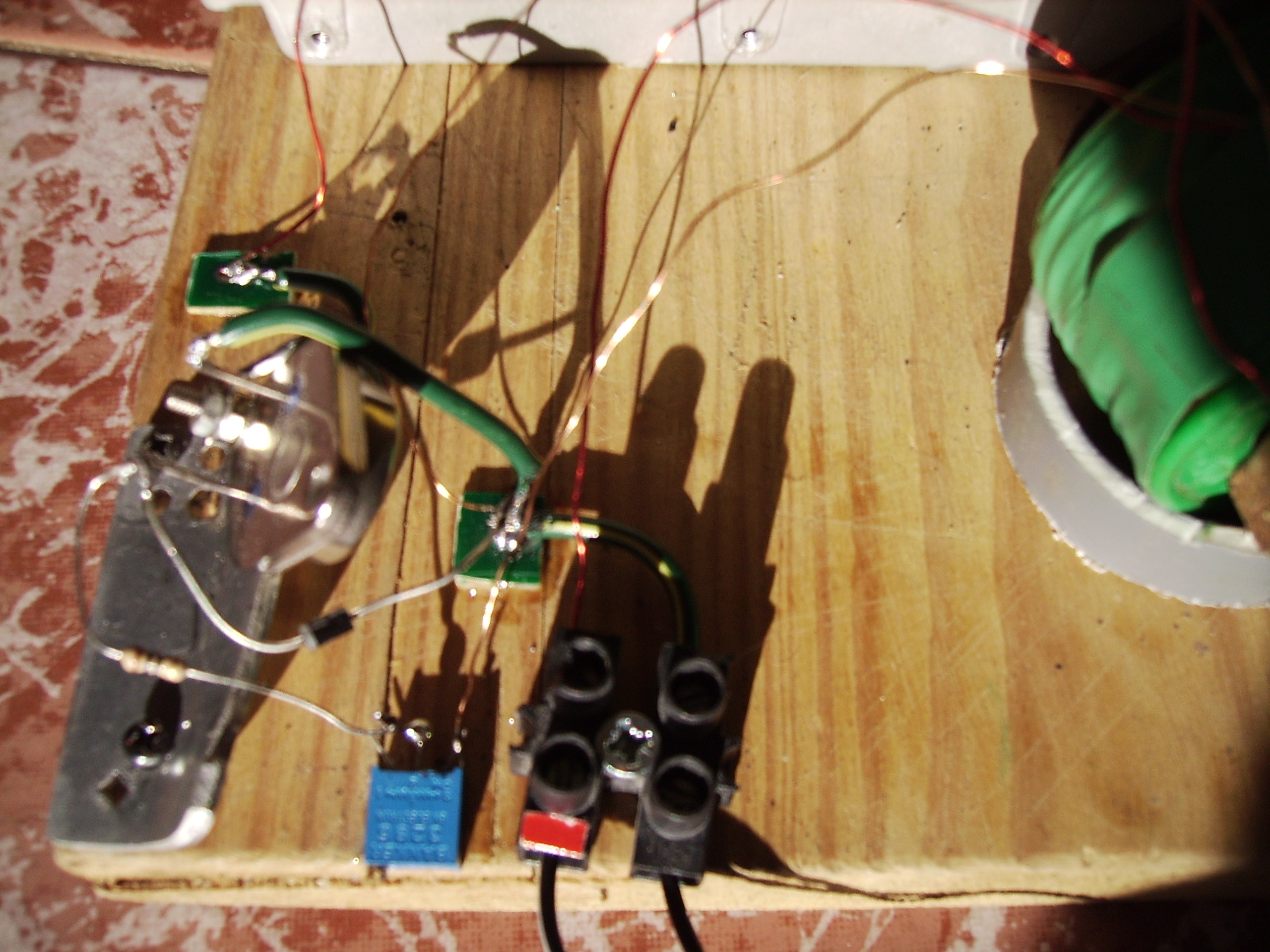

                    • SG diode query
                      Hullo everyone. I'm tying to put together my first SG, and I have a couple of questions to put to wiser heads.
                      1. I am currently trying a 1N4004 diode, which was the nearest the shop had to the 1N4001 recommended. The only difference seems to be in the voltage rating (400 instead of 100). Would this do the job? I also have some 1N4007s available.
                      2.I couldn't get a neon bulb so I tried using a low Ma incandescent bulb. Is this any good or would I do better leaving it out altogether? (I have it in series between the diode and the emitter, as shown in one of the diagrams).
                      3. I'm using four small 1cm diam. neodynium disk magnets. I'm a bit confused here because some people seem to recommend them while others say you should only use ceramic magnets.
                      As you've probably guessed, the circuit doesn't seem to work. I've checked the usual things, coil direction (about 400 winds) showing north to magnets' north. Without the core, the coil sometimes emits an oscillating whine which increases in pitch. Does this mean anything good or bad? When a clip slipped and briefly shorted the emitter to the casing I think I saw the rotor move slightly. When I connect and disconnect the circuit, I can hear a faint clicking sound coming from the rotor (based on a HD drive so quite free running).
                      Any suggestions would be gratefully received.

                            • I do not think, that the problem is in the coil. 400 turns should work just fine. Can you post some pictures of your setup? Check if all components are working and if everything is wired exactly as in the diagramm. Maybe your transistor is fried, maybe something else. Hard to say
                              • Re. Diode query
                                Here are the pics. I've resoldered and rechecked everything. One thing I notice is when I put a meter across the 10 ohm resistance (negative probe towards the transistor only) the coil begins to oscillate and the rotor tries to turn.
