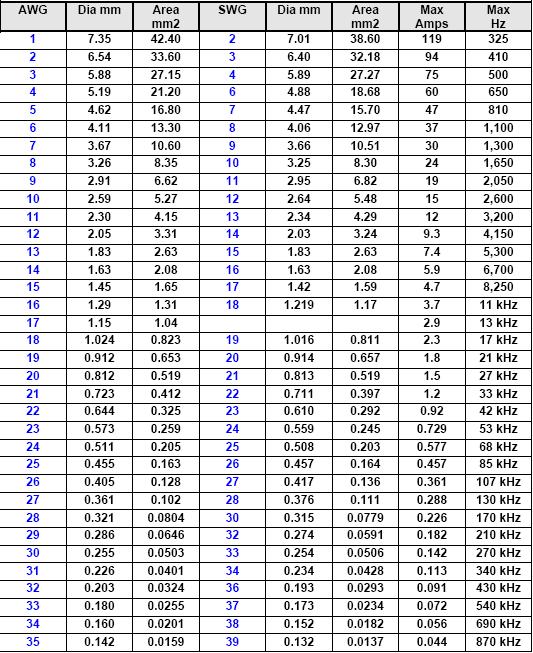

      Wire sizes - AWG vs mm
      For the benefit of everyone, just so we are on the same page.
      This was screen grabbed from "A Practical Guide to Free Energy Devices".

        and amigo thanks for the table.. it is really very usefull
