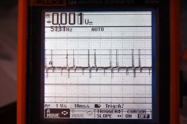

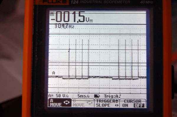

        What bugs me even more is that I get quite different waveforms depending on the batteries I use. I'm attaching some examples...
        First scope photo shows just a motor setup (no second battery) while the second one has a second battery in (don't mind the noise in the waveform, comes from the AC adapter scope is hooked up to).
        When I wind the rheostat to what I think is over 1k resistance, I eventually reach self-oscillation point, but the waveform changes as well and becomes more uniform, with consistent spikes, sometimes as large as 200V.

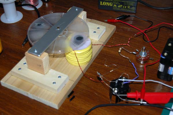

        I think my disc/magnet assembly needs to be reworked, I did not have bearing assemblies or an axle, so I used bearings from a broken CD-ROM unit and as a result the disc with magnets is suspended above the coil, held by the aluminium bar across.

          Here's what I also wonder and if it sounds newbieish - it is, should the neon bulb turn on as you wind the pot towards the higher resistance on the base circuit?
          I have tried different combos, things like 10 ohm resistor and 25 ohm rheostat as well as 100 ohm resistor and 1 K rheostat, but I noticed that there's a threshold when the NE-2 lights up and starts pulsing at some low resistance and then it just gets brighter and pulsing starts changing into constant light.
          I also forgot to note that my coil in the photo there is wound the opposite way (I'm left-handed and I blame this right-hander's world for making me do so ) but it still appears to be working.

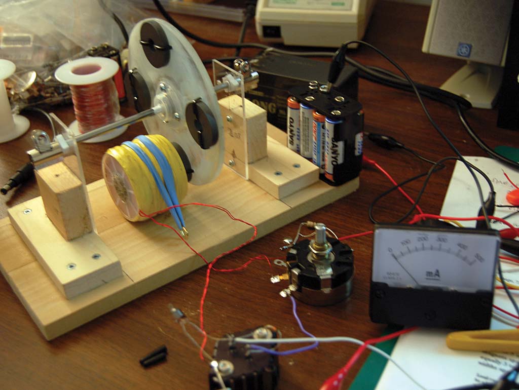

              Well, I managed to improve my contraption by several levels of magnitude.
              I have moved the shaft to horizontal position, got real bearing assemblies, and changed my rotor to be more sturdy (four clear plastic discs from blank CD-R cases glued together ), as well as put more powerful magnets (Electronics Goldmine G16370, $0.40 each) which I found to be one of the key elements. My older smaller magnets (see pictures above) did not seem sufficient enough - with the new ones rotor requires just a gentle push to start.
              I still think my coil is wound in a wrong way (damn you right-handers World) so it might have to unwind and wind again (sigh). Though it still works so what gives?
              I've hooked a mA meter to the circuit and a 10 ohm resistor to the secondary/charging output, so I can fine tune the rheostat and transistor base voltage to lowest current usage from the primary.
              Amazingly enough this assembly can draw as low as 50mA (or even less) which with the 8x1.2V 2300mAh batteries I use to test with means I can run hours/days?
              This has pretty much encouraged me (by a number of folds) to proceed into next stages and acquire a more serious quantity of magnet wire and wind more coils

                hey amigo, your setup looks really good. i havnt yet started to build this stuff yet, im still gathering data, and resources before i begin.
                with having a coil situated only on one side of your rotor, do you experience an unbalanced rotation? by that i mean is there unequal stress(on your bearings) on one side due to the electromagnetic "pressure" from your coil?

                  Hi Bryan
                  I think fabrication in home environment to begin with is a nightmare. I live in a high-rise apartment building so you can imagine a limited amount of woodwork and metalwork one can do.
                  Now, my rotor appears unbalanced as it is, when I was gluing plastic discs together I think I put too much glue in a layer on one side. Then, because I mounted two bearings on the sides of the rotor and did not have a proper mounting points the whole thing seems to be off axis slightly (heck I'm lucky it spins without too much wobble).
                  I do not have means to measure any stress except to visually discern that there is some drag happening. I think the better setup is the roller skate wheel one where gravity aids the process.
                  I suggest you start somewhere, see what kind of materials you can gather and build your first prototype. Finding the right parts sometimes proves to be a real pain - not everyone has a machine shop available to them. Besides, your SSG can't look worse than my first one
                  From there you will realize mistakes and correct them on your own pretty fast. I was amazed myself with ideas I came up to fix things after the first trial run, even though I had to scourge for parts and come up with all kinds of ways to supplement the lack of real machined components.
