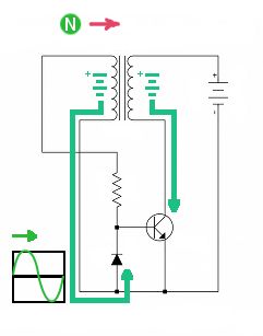

                  The current hypothesis
                  Now that I know what happens when a magnet passes by a coil, I can see there were some flaws in my original characterization. Hopefully this will set that straight.
                  Looking at the first picture, we see a magnet coming in towards a coil, attracted towards the iron core. As it approaches it induces a small current in both coils (represented on the schematic as small batteries). In both cases, the current is blocked and so nothing happens.

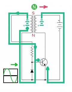

                  Moving on to picture #2: Once the magnet passes the center of the coil, the current reverses direction. At this point, current flows in the trigger loop thus also biasing the transistor on. Also, during this whole process, the iron core of the coil has become a temporary magnet with the south pole at the top and the north pole at the bottom.

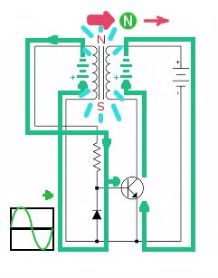

                  On to picture #3. Now that the transistor is biased on, current is free to flow from the battery through the transistor and on into the coil. This causes the magnetic field in the core to abruptly switch polarity, causing a sharp gradient in the local virtual particle flux in the near vicinity of the coil and the appearance of radiant energy. The scalar south pole may also play a part in the radiant event as well--my knowledge in this area is still woefully incomplete.
                  At any rate, the magnet gets a strong kick away (the scalar south may also be attracted in at the same time, YMMV) from the north pole that is now manifest at the top. As the magnet moves away, the current in the trigger wire stops and so the transistor stops conducting and shuts off the battery. Some of the radiant energy flows to the source battery, keeping it from running down too quickly. As the next magnet comes in, the cycle repeats.
                  Anyhow, that's how I see it. Any comments and clarifications are most welcome!
                  • #54
                    sg diagraming
                    Hi Shamus,
                    These diagrams looks great and I'm doing my best to keep track of what you're showing.
                    In the middle pick you have electron current moving into the base and up through the emitter at the same time. Would those oppose each other?
                    It is personally difficult for me to follow circuits based on electron current.
                    With 3 flows around a circuit:
                    1. Pos potential moving from + on dipole towards negative.
                    2. Neg potential moving from - on dipole towards positive.
                    3. Electron current moving from - on dipole towards positive.
                    I usually look at circuits in terms of how is the positive flow moving. Then I automatically know that the electron current is opposing that.
                    • #55
                      Hi Aaron,
                      You're probably right about the transistor, since it is an NPN type the current would probably flow out of the base towards the current loop on the trigger side--I don't know all that much about them, so this is another hole in my knowledge. Any pointers to good material on the subject would be most welcome. Other than that, I made diagram #2 show the current flow just before the base is biased. So I probably should have clarified that.
                      For me personally, I have to think in terms of electron flow in order to think about how the circuit works--I blame the physics classes I took at uni for that. But yes, you could draw flows going out of the positive ends of the little batteries and everything as I've described it above would still hold true.
                      On other thing of note here is the resistor. What that does, from what I can see, is narrow the amount of time that the base of the transistor is biased. So if you have a low ohmage there, the base of the resistor will see most of that negative sine wave pulse. As the ohms go up, the base will see less and less of that wave (think of the amplitude of the negative wave going towards the zero line). Once you have so much ohmage that the base doesn't bias on, then you have self-oscillatory behavior which I don't fully comprehend at the moment. But the thing to keep in mind is that this circuit isn't configured to properly handle that.
