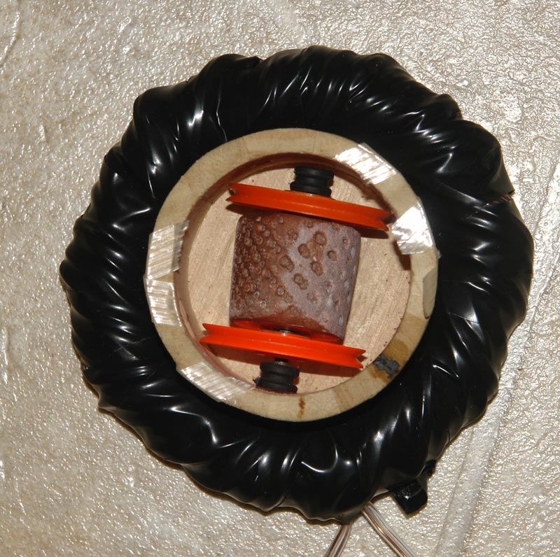

            • Speed record
              I hit 25K R.P.M. with this Celtic Knot, one ceramic bearing Bedini. That was before I applied the experimental epoxy on the 1" Neo. I don't know what the 2" Neo would do, but I'm willing to bet any amount of money that it will outperform Skycollection's setup. I start the Spinner inside the coil air core, then I have to lift the cup up and reposition it over and a bit to one side to achieve the super acceleration. I fish around for the peak spot with a laser tach. A few millimeters adjustment can add thousands of R.P.M. It would be possible to build a brace for it and just slip it into peak position after the runup.
              I would have to wrap a wider diameter Spiral Knot Coil to fit the 2" Neo. About a ten minute sloppy lash wrap job for me with the Radio Shack 75 foot length, 24 gauge solid 2 conductor speaker wire. When the air core diameter is too small, it's necessary to first wind the wire on a stick to fit it through the hole. I think the 2" air core would be large enough to pass the spool through for half the work. "There's no jelly in a doughnut hole": Ampere.
              • Originally posted by synchro View Post
                The dimpling helped, or is balancing an issue?

                • Dimpled spinner.
                  @Twinbeard,
                  The problem with balancing the epoxy was that it rolled on a bit lumpy, then I dimpled it over the cheese grater while still wet. When I sanded to balance, the heavy side worked the dimples to low as you can see in the photo. I'm stuck with this flaw. The spinner begins to wobble over 5K due to this aerodynamic asymetry, as I have it balanced on a single central bearing. Live and learn!
                  I couldn't get a round to connect the contacts on the brass discs. My best reading was about a 1/10 of a volt, but I was unable to measure amperage to load due to the oblong nature of the casting. I did determine that it's retrograde to spin the magnets with the copper disc, so I disassembled it and ordered new materials to marry the fixed stator Faraday to my Spiral Knot Bedini.
                        @Twinbeard,
                        You can't crack the epoxy off?
                        Yep, when you put a cut or nick in the cover of a golf ball, it flies funny. I think that has to be done pretty precisely to have the proper effects... millions spent on golf ball research may not be wasted after all though!
                        Maybe apply epoxy, let it dry, sand to balance, then dimple with a Dremel tool or so. Hell, applying a sandpaper type surface would likely work as well. Maybe just some glue and then roll it in sand.
                        Anyway, thats how all good engineering gets done. If you get it totally right the first time, you are either totally lucky or totally bull****ting. When I do something, I expect the first 3-4 to fail miserably. I mentioned before... the first few rocket launches that actually made it to space went too far, and thats after how many explosions, curveball flights, and other screwups. Do not be discouraged! Remember Monty Python and the Holy Grail:
                        "King of Swamp Castle: When I first came here, this was all swamp. Everyone said I was daft to build a castle on a swamp, but I built in all the same, just to show them. It sank into the swamp. So I built a second one. That sank into the swamp. So I built a third. That burned down, fell over, then sank into the swamp. But the fourth one stayed up. And that's what you're going to get, Lad, the strongest castle in all of England."

                        • Speed record
                          I knocked and sanded the epoxy off my 1" neo tube magnet and rewired my Bedini SSG with a 2N3055 metal can transistor for the smaller burned out TIP3055 and ran the spinner up to 29,298 R.P.M inside the Spiral Knot Coil for a new speed record.
                          NASA chose two circular Hallbach arrays nested one inside the other for it's Mag Lev rotor, one set on each end. Each set has a smaller inside one with the field pointing out, and a larger outer one with the field facing in. The Mendicino version Skycollection uses vibrates very subtly, invisible to the naked eye. That's why I believe his top speed of 17+K is vastly slower then my single ceramic bearing. Also I believe my Spiral Knot Coil is much more powerfull then his Rodin Starship Coil. The Spiral Knot acceleration rate is much greater then his.
                          I have a 1 Farad Rockford Fosgate capacitor set up for a trial run with the magnet core output coil back to source circuit. I hope to have a self runner soon.
                          I fooled around with the Cook generator, trying to bend the magnetic field with positioning magnets, but met with no success. I don't know if my theory's wrong or if my technique is faulty.
                              Cool. I'm glad I did not ruin your rotor with my aerodynamics ideas. I was actually feeling kind of bad about that. To make up for the hassle, can I send you a mosfet that should be able to switch a little faster, gratis? Oh, and if I can talk you into some elmers glue and sand on the surface of the rotor to make the aerodynamic effect...
