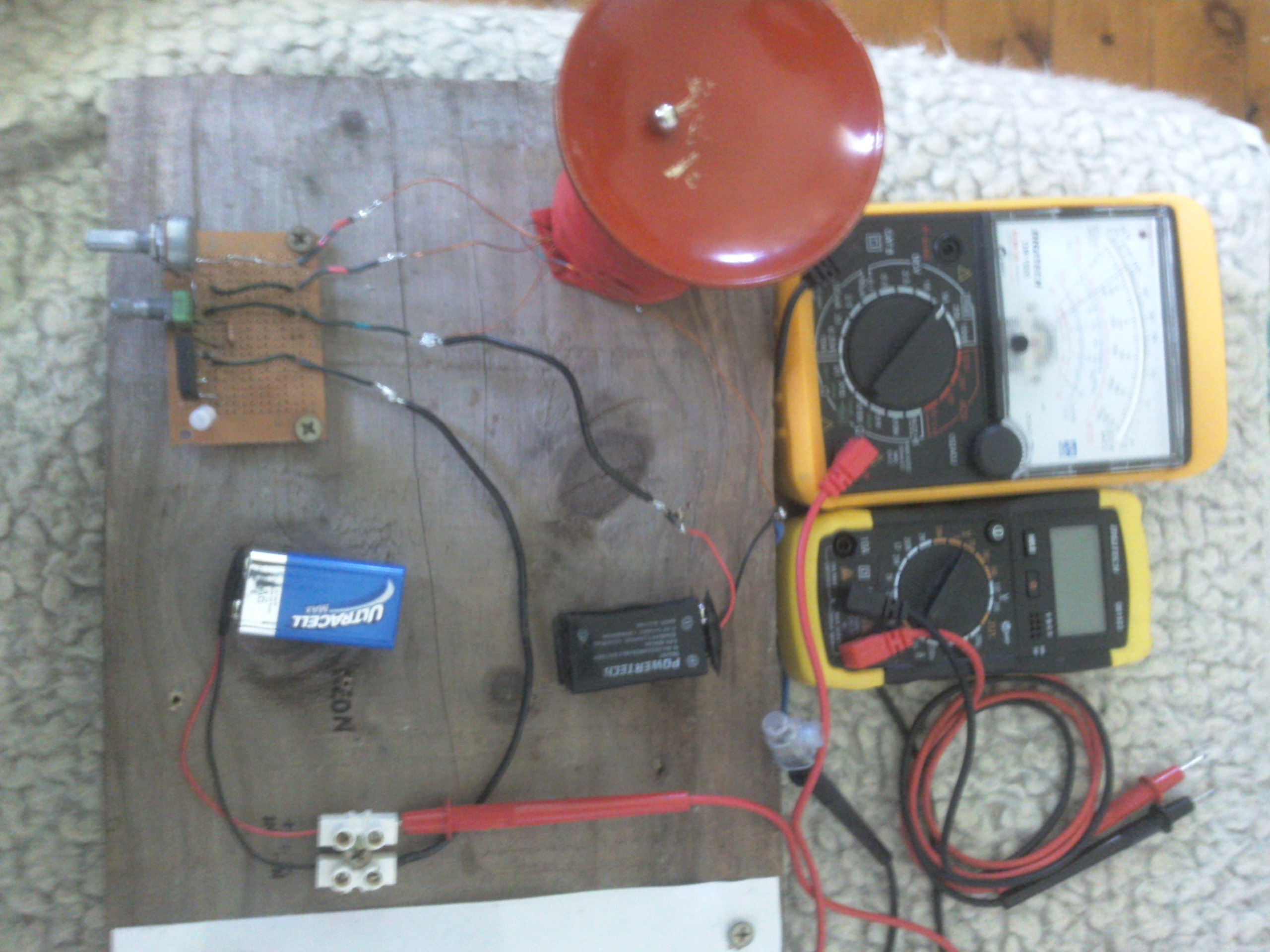

              • Hi All
                Have been off shore fishing for the last 2 and a half weeks so I apologise for dropping off the planet. I thought I would place another post and let you guys know where I am at. So far I have still failed to get this spinner running. I have changed the configuration of the circuit in a number of ways to accommodate all of your recommendation but still no luck.
                To Allen Burgess I wanted to say that I have tried your Idea of using the daftman bedini layout with two batteries and no capacitors and this is the current configuration I am using. I have tried different coil wire positions but they proved to be detrimental.
                To Jonny Davro I wanted to say that I have an analogue amp meter in series now. When I set the base to 10 ohms I have a current draw of 250 mA. At 1000 ohms the draw is 35 mA and between the two the relationship between resistance and current is linear. At no point can I get the needle to jump by spinning the magnet. This is also true with the coil laying sideways and the magnet on a concave dish.
                To Joit, I have tried your idea of reversing the trigger coil wires but this renders the entire circuit dead with no current draw and no oscillation.
                I am posting a picture of my circuit and I hope it helps give you a picture of what is happening. At present it is a bedini SSG exactly, without any modification.
                Doug
                • Just a quick update.
                  I used a glass test tube to get the magnet into the core of the coil, waved a magnet past and the whole thing came alive. Have little in the way of readings other than 150 mA seems to be the sweet spot for starting the magnet before adjusting to around 15 mA. Will post further results as they come.
                  Doug
                  • A further update
                    I am getting the amperage of the circuit as low a 10 mA until I add the automotive relay coil. At this point the amperage is 250 mA at best. Am not entirely sure why this is happening but I have decided to omit it from the circuit completely. I have introduced a slayer exciter circuit similar to jonny davros youtube video and at 10 mA a 2 foot fluoro tube glows at medium brightness.
                    Overall I am happy with this circuit as it offers an extremely energy efficient way to produce light. I have had no luck using the bedini circuit to charge batteries though, for some reason my circuit does not achieve this using nickel cadmium, nickel metal hydride or lead acid batteries.
