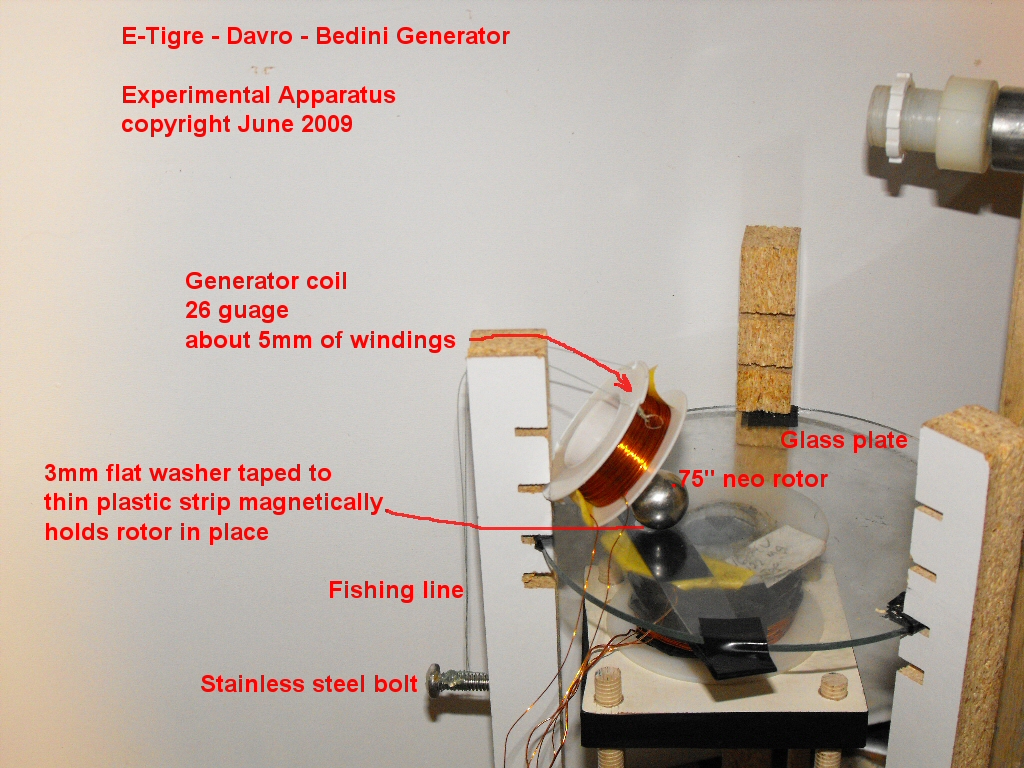

                          • Generator Design
                            Gentlemen,
                            I will be forced to suspend my experiments for some time due to moving to a new home. I wanted to leave you with my most interesting experiment to date in hopes you can advance the state of the art before I return. I have conducted a very very interesting and encouraging generator experiment and I hope you can replicate it and advance it. Please refer to the attached picture for explanation of the apparatus.
                            This set up permits very fine adjustments of the pick up (generator) coil by means of a simple draw bridge mechanism. The one sphere rotor is held in place by magnetic attraction to a flat washer underneath the glass base plate. This arrangement permits fine adjustments to the rotor location during operation. I am using 3 NiCad tool batteries 14v for all experiments. (They charge to about 16v and operate well down to 12 volts. ) One battery supplies the drive coil, one collects the Bedini back pulse and the generator coil is attached to a bridge rectifier and the output is connected to the 3rd battery directly.
                            This apparatus can generate over 30 volts at the rectifier output under no load. When you slowly lower the generator coil down to a 45' angle over the rotor, the charge rate is exceptional and the power consumption was steady at 148ma. Rotor speed and charge rate are governed by the lenz effect.
                            After charging the battery for some time, I then took the next logical step and connected it directly to the Bedini coil supply input battery. The voltages stabilized immediately and then held for a long period, slowly reducing over an hour or more. This is much much slower supply drain than normal. The test was discontinued when I damaged my transistor with a voltage spike from a capacitor I was attempting to introduce into the circuit.
                            I stress that this set up is NOT optimized for performance in any way. Those with greater electrical knowledge should be able to reduce the current draw on the Bedini coil and/or increase the current output on the generator side. (I do have a Sepiroth style relay/choke coil in the Bedini circuit) Mechanically it is primitive as well, so I am hoping all of you can replicate my encouraging results and build on them. This set up also charges a battery from the Bedini back emf at the same time, so clearly, we are just a few milliamps from success with this one.
                            best of luck...
                            When you pick up a cat by the tail you learn things you cannot learn any other way...
