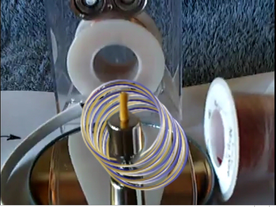

                            ive been thinking about stuff like this for awile but i really dont have the parts or the time to try them , but i had an idea of maybe trying a half iron core coil with a plastic coating so the sphere neo magnets can run freely and the air coil in the mid of the pic is just an extra dont really need it but i thought maybe it would be good ?? tell me what you think it was just an idea
                            i spent sometime working on this crap drawing
