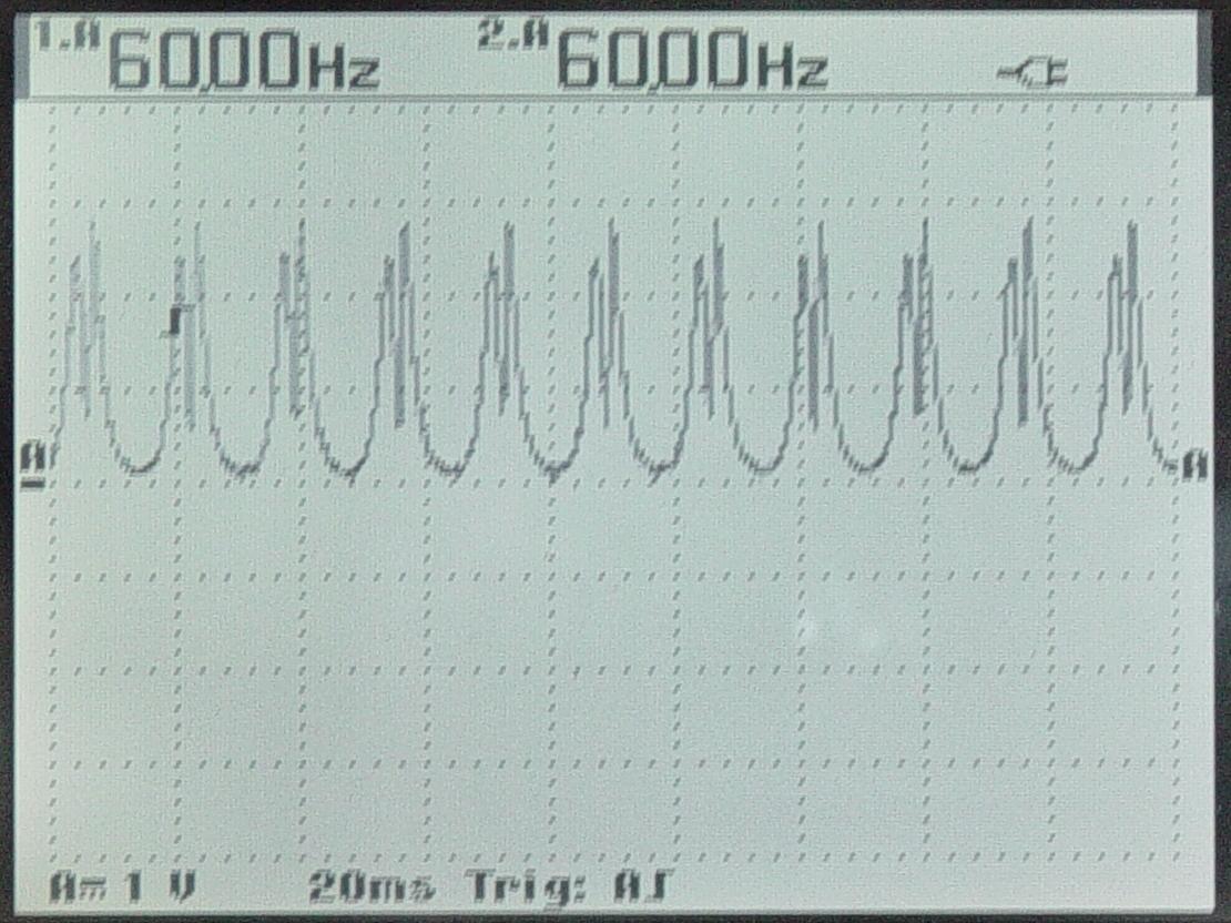

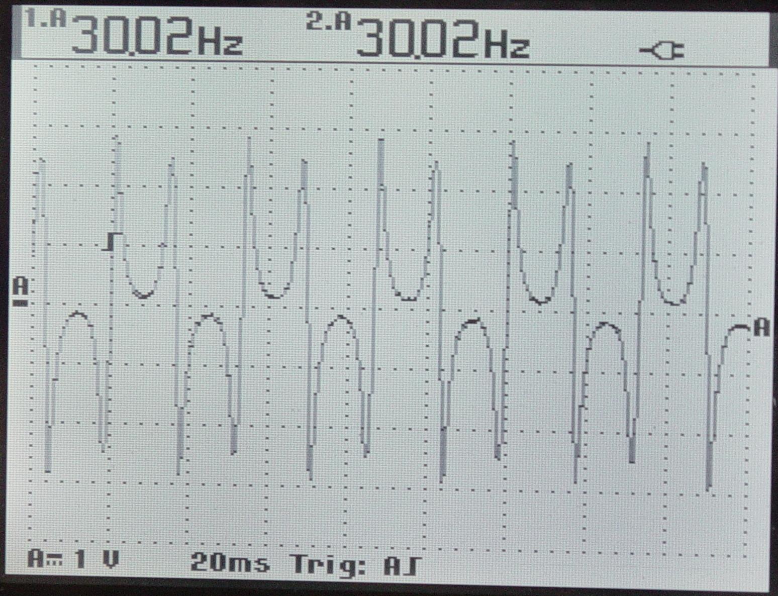

          It looks like a big sine wave that has been inverted part way up the pos slope and the sine pulse rides down and back up - same on the neg part of the wave. My thoughts are the magic is in that quick reversal, but could be wrong
          That's my thinking, too. I have considered that scope picture at length and tried to fathom it. It almost looks like a bounce, as if the signal overshot and snapped back, or hit some invisible boundary and reflected back on itself, before reversing polarity.
          Just thinking aloud... I wonder if there is a way to precisely correlate the signal to the physical position of the coils in their rotation, and if there is any point in bothering?

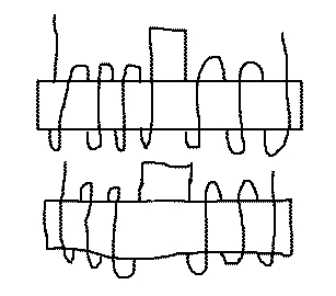

                • VERY different
                  I couldn't find the picture I remembered, so I drew a very lame one to illustrate.
                  Simply switching wires around does NOT always accomplish the same end result as rewinding a CW winding into a CCW winding. In the picture below, no matter how you configure the two separate windings in the upper coil, you can never achieve the same result as in the lower coil.
                    If you guys can post a link to the waveform picture and a picture of the setup I should be able to explain it to you. Once you understand what's going on it should allow you to just look at any kind of generator and visualize the output from it.

                    • Kent: Re: The drawing with the two coil examples. Your lower coil is a combination of a CW coil followed by a CCW coil on the same core. That's something that you never want to do because if the two halves are the same number of turns they will cancel each other out and there will be no inductance at all.
                      What I said about simply swapping the wires from the coils to make sure they all add up is true. Of course I am assuming that in the convertor both coils are passing by their respective magnets at the same time. You can look at a coil output as a device that generates a "differential" output. The only thing that is important is the difference in voltages across the two terminals of the coil. If you flip the wires of the coil, it's the same as reversing the wires of your multimeter, when the instantaneous voltage on the terminals measures 10 volts, you can flip the wires of the coil, or flip your multimeter leads, and you will measure -10 volts. It's like you can get a mirror image of the voltage waveform just by swapping the leads. I hope that helps!
                      • Bingo Kent
                        Bingo Kent -
                        Lefthand and Righthand rule dates way back. your description makes sense to me and I'll tell you that coil bugged the heck out of me to where i was reduced to winding a string around a dowel rod and flipping it end to end. I do not know why but it did not give me the wave form i wanted until i rewound it. Here are my wave forms - rectified and full wave.
                        One the waveshape issue you can trace a large sine wave, set the paper down in front of you and fold the top section down over the bottom with your crease half way up the positive peak. Then the same with the bottom folding it up over the top half way up the negative peak. Put it upto the light and what do you see? To rectify it fold it in half top to bottom.
