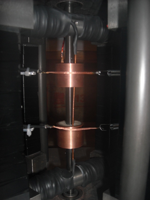

              • Timm have you changed the brushes recently? Or are they the same size as the ones used for all past experiments?
                • Originally posted by ren View Post
                  Hi Ren,
                  Yes... this was a new brush set-up. I was using graphite/carbon brushes (images in earlier post), and John suggested they may add too much resistance and suggested copper/carbon brushes. Everything I found was expensive ($45 per) so I thought I'd try used braided copper (desolder)(new image above). They aren't a long term solution but they're a low resistance short term solution.
                  What I don't understand is I had the amp load delta down to 0.2 amps in the first configuration after moving to an aluminum shaft, but this one didn't perform as well (0.8 amp delta). In the video John always prefaced his statements with "when wound correctly"... so I'm thinking that is the key, but unsure what to try.
                  I still need to think about this somemore but thought my inductance figure might give me some insight into impedance at the higher frequency and pulses.
