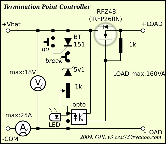

[PSU] -> [75mF CiS] -> [75mF capacitor ("condenser") ] -> [TPC]-> (Lightbulb)
what is a #*@! [TPC] ?
It is a simple device called Termination point controller. There are many types, they just switch off the load as a preset condition has occured.
I had made a really simple TPC that triggers off the load if 11V...17V level is depleted on the powering side.
This way, the bulb would pulse, but the PSU would never see a Capacitor loading it lower than the TPC set voltage - be it 12V or what ever looks fit.

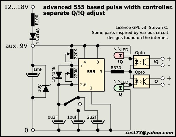

To avoid being seen as "just thinks" I share some of my work
enjoy (if found fit)note:
The TPC v0.1 is a bit Lying
