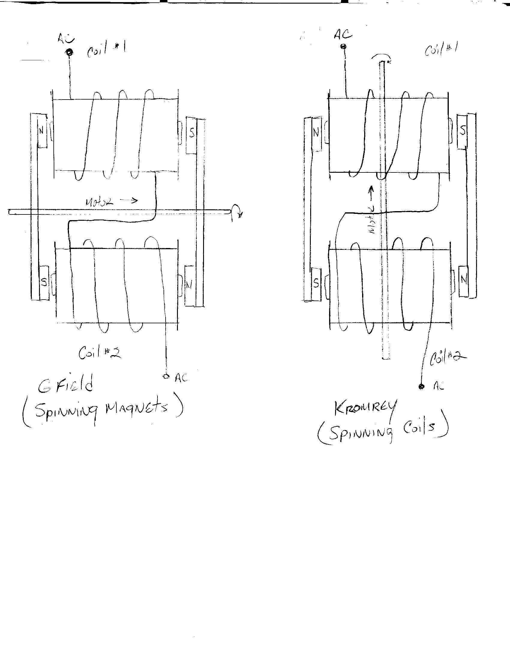

                    I did a drawing of my coils as they are wound now in series and how it relates to a Kromrey. The Kromrey is on the right and GField on the left. This may help with your coil config since it is my opinion they are the same. Note the shaft going verticle thru the coils that would spin the coils inside of the stationary magnets (Kromrey fashion). The thing I like about GField is the magnets are easier to spin, no slip rings and the magnets can be adjusted very close to the coils without fancy machining on the coil ends or pole pieces. My purpose is not to change your direction to Gfield instead of Kromrey but to help with coil winding for the Kromrey. I no longer think I would wind the coils like the post I just put up from the net where all outside poles are the same. Instead I would wire mine like in this jpeg posted here. one coil wound cw and the other ccw just like Bedini showed in the video except when he gets to the right side end he comes from the front of the top coil continuing in the same direction back across the front of the bottom coil. Which if you look at it is the same cw and ccw coil arrangement. I believe (and my work shows this to be a high probability) when John got to the right side end he should have gone from the front of the top coil to the back of the bottom coil opposite end and wound that coil in the opposite direction all the way down. Again the cw and ccw wind is the same so how John did it may work as well. I will test this later today and let you know if I get the same results. So many possibilities
                    Peunphysics

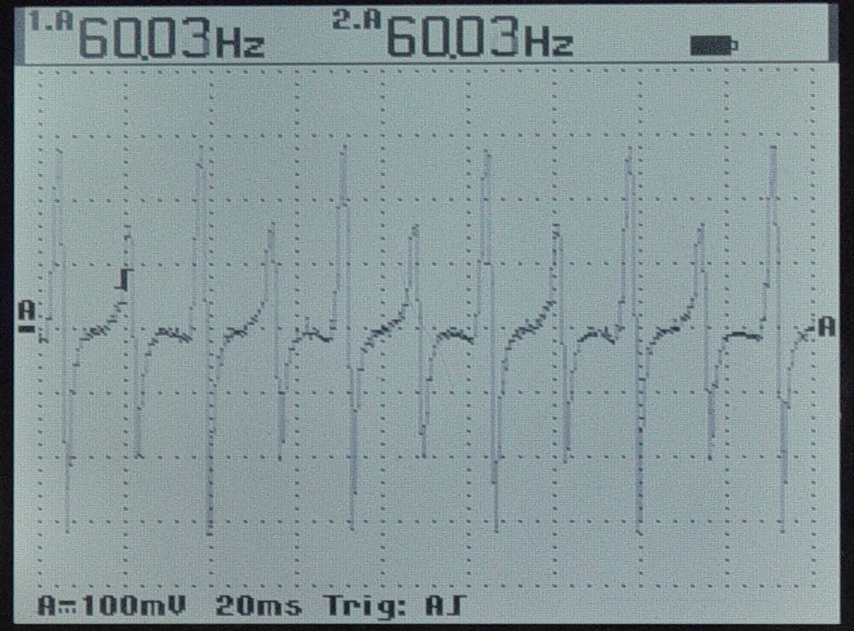

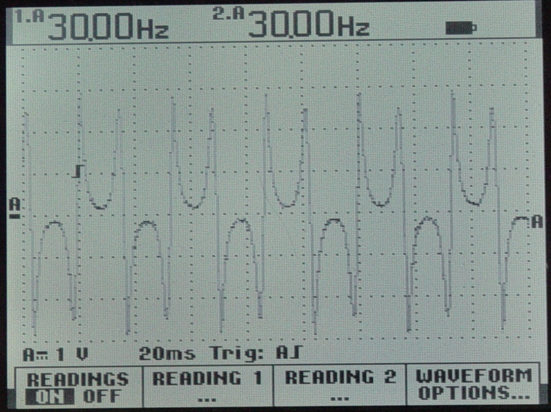

                        Very interesting! One jpg wired like John shows directly from Video. The other is same as mine Back of top coil tied to front of bottom coil. I like johns cuz if i rectify it i should get twice the pos pulses. hmmmm. anyone? thoughts? Cannot answer your question yet on starting end but you do get a different wave for sure.
                        Pneuphysics
                        • Pneuphysics: Sorry, but it looks to me like the scope capture on the right is an example of when you have miswired the coils so that they are not adding together. Instead they are subtracting from each other. The clue to this is that the voltage scale on the left scope capture is 1 volt per division, and the voltage scale on the right scope capture is 0.1 volts per division. Since output power is proportional to the square of the voltage, the setup for the right scope capture can only produce 1/100th the power of the setup for the left scope capture.
                          You still get an output waveform becasue it is almost impossible for both coils to output exactly the same voltage at the same time. You can see that one of your magnetic flux paths couples better and dominates over the other flux path because you are not seeing any inverted fly-by waveforms. You can also see how one coil is slightly different from the other coil because you have alternating "high" and "low" fly-by waveforms.

                            • pneuphysics:
                              I have a question regarding your schematic in post #328, "Kromrey vs Gfield.jpg". What is the difference in the waveform output between 1) wiring the G-field as you have drawn, and 2) reversing the leads on coil number two?
                              In other words, you have drawn it wired this way: Top Left=out, Top right connected to Bottom Left, Bottom Right=out. What does the waveform look like if you wire it this way: Top Left=out, Top Right connected to Bottom Right, Bottom Left=out?
                              Is that what you've shown with the two scope shots in post #330, "The way mine are wired Crossed.JPG" and "Wired like John shows in Video.JPG"?
