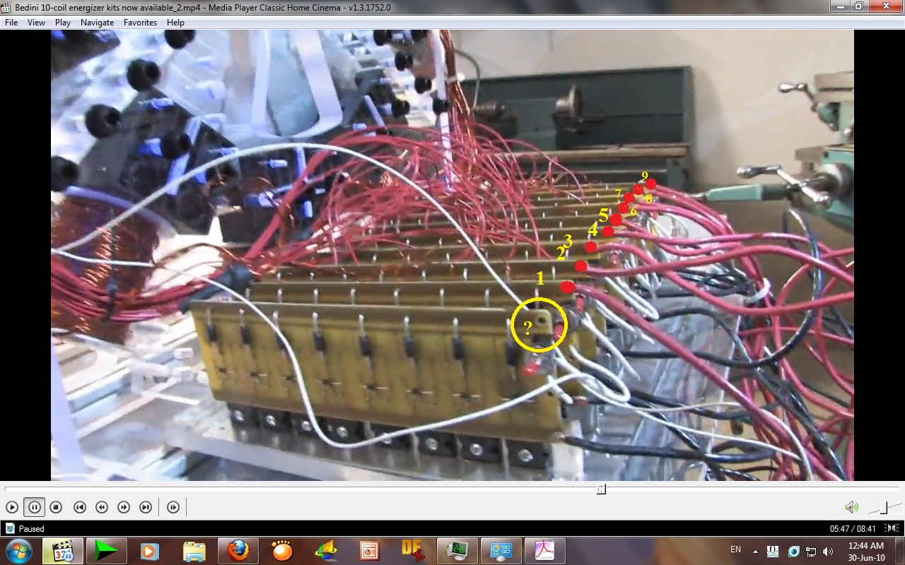

                    • Trigger coil
                      Hi bit's
                      I have seen the Rick/john video, demonstrating the 10 coiler. In their video, when they were showing the circuit at the back (some sort of music was also being played at the background), In the video, i saw that one of the transistor panels was not connected to the thick red wire. This thing made me think that there are only 9 power coil, and 1 coil is fully devoted for triggering i.e.,
                      { 9coils(slave/power coils) + 1coil(master/trigger)} = 10 coiler energizer
                      That's why, in the video they showed 9 transistor panels connected/soldered to their respective thick red wires (located just above the switches), and the first panel (the left most panel) was left alone. and i thought it was extra, because there were only 9 coils to power and 1 coil on the whole was used only and only for triggering.
                      So to power 9 coils so 9 transistor panels were necessary and one (left most) panel was extra. (plz see the picture on the my next post, it will make u clear what i am trying to say)
                      But when i saw the picture of the transistor panels on ur motor, each and every row of transistors panel was engaged with copper wires (not connected though). from this, it seems that the trigger coil (or master coil) must have 9 filer wire, 8 for power, and out of 9 strands, one strand of coil was firing all 80 transistor? i mean that the trigger coil is not wholly Solly devoted for triggering? am i right? which is statement is correct, this or the above?
                      1:kindly please explain me about the number of wires per coil, and how is the triggering achieved?
                      2:And are the transistors used in Rick's motor are MJL2119?
                      3:what is the value of triggering series resistances and their wattage?
                      Thanks alllllot.
                      • Hi Bit's
                        Hi
                        plz see the picture that i have uploaded, yellow circle shows the missing wire(which is confusing me) rest of the nine red dots that i made in the picture, is to show the connected wires.
                        so plz tell me which coil do the triggering?
                        one of the coils is fully used for triggering or all coils are participating in their own respective triggering?
                        if there is one trigger coil does it have both the trigger and power coils wound on the same bobbin? if so, then how many strands are there in total on that bobbin, and how many of the strands are devoted for triggering only.
                        The thing that surprises me is that, firing all 80 transistor at once is a too much load for single strand trigger coil, so no transistor will go to perfect switching mode (saturation state). so plz me it clear.
                        Sorry for taking so much of ur time. If any one else who knows my answer, plz reply, i have seen that the Plasma dude have also purchased on of Rick's 10 coil, so he can help me out too.
                        Finally, what would you people who have bought Rick's 10 coiler suggest me, should I buy it? is it worth spending any money, because I have not see any concrete evidence that I can fully power my home with it. b/c u guys are barely managing it to get close to cop=1 + allot of modifications, how would it power a house then? plz dont take it negative. I am not discouraging any body out there, u guys are doing really really great. I am counting on bit's and Plasma, if they come up with great cop then all our efforts will not go wasted.
                        So ur suggestion for me would be.......should I buy one?
                        • Originally posted by Hammad View Post
                          Hi
                          plz see the picture that i have uploaded, yellow circle shows the missing wire(which is confusing me) rest of the nine red dots that i made in the picture, is to show the connected wires. This also should be connected like the 9 other
                          so plz tell me which coil do the triggering?In the bottom most coil you have 8 individual strands(as you do in all of the coils). Take ONE of the strands and hook one end to ground, the other to the pot, then light, then anyone of the switchesfor the trigger circuit (typical Bedini fashion)
                          The thing that surprises me is that, firing all 80 transistor at once is a too much load for single strand trigger coil, so no transistor will go to perfect switching mode (saturation state). so plz me it clear.You need to read more on the SG circuit to understand the switching
                          That is totally up to you to buying one, but you'll not find any better in the progression of unlocking the possibilties of free energy.
                          Bit's

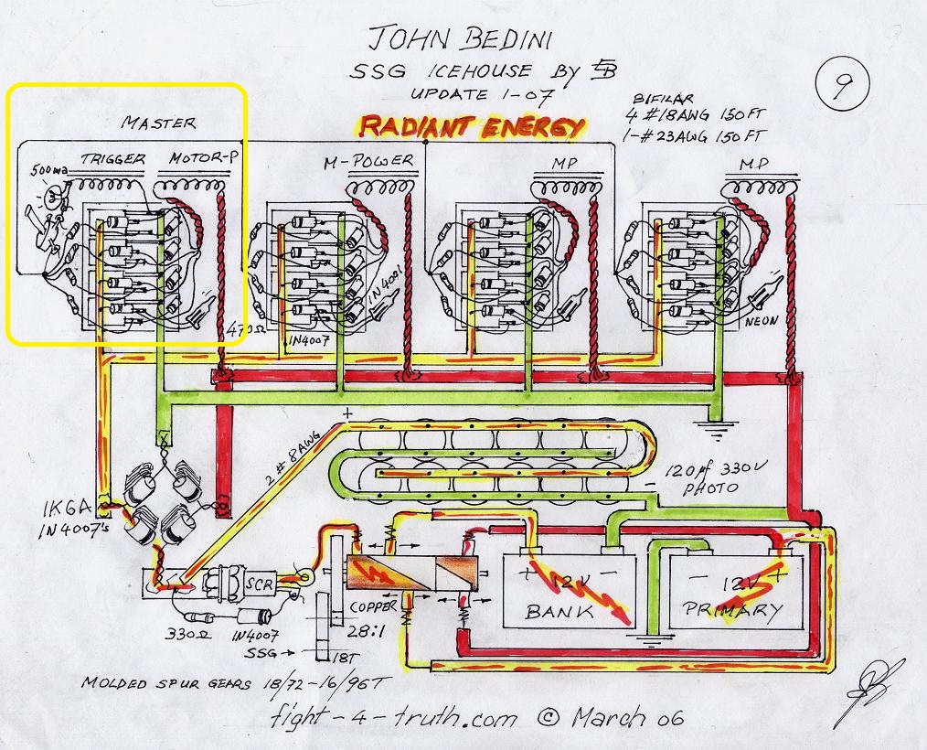

                            • About the coil connection
                              Hi, thanks for reply.
                              My dear i am an electrical engineer, and I am Lecturer at my university. I know exactly how switching is performed. I just asked u the configuration of the trigger and power coils. I know any of the configuration would have had worked, but I want to know exactly what was the approach that Rick used to trigger his coils.
                              I am into Bedini motor for 3 years now. But due to my busy schedule, i cannot devote too much of the time making a lot of Bedini motors. though I have made few using cpu fans, but they are so tiny to have any pronounced effect of cop close to 1. Even right now, one of the fans is charging my gasoline generator's starter battery.
                              Form ur kind reply, I conclude that there is one strand (for triggering all transistors), that can be taken from any one of the 8 filer coils. And by using bulb and resistors (in series, just shown in the picture I uploaded, only the switches are missing), we supply triggering to all 80 transistor (79 to be exact). And to select which of the coils should be made online, we use switches and supply the triggering pulse. Am I right?
                              For clarification to what I just said, plz see the circuit diagram (though it is not exact, i am using this picture just to show u the power/trigger coil configuration, rest of that motor/energizer is a bit different form 10 coiler as it uses SCR, capacitors etc.), I made a yellow rectangular box around circuit, showing 1 trigger + 4 filer power coil, but here trigger coil is not one of the power coils, but it is an extra one, wound over the normal 4 filer coil. That's why i asked u if the master coil had 9 wires (instead of 8)
                              But if u take one wire for triggering(from any one of 10 coils), then that particular coil should have left 7 coils as power coil, and for switching that 7 filer coil (as 8th wire is devoted for triggering/switching) u need 7 MJLs, so total number of transistors responsible for driving the motor would be:
                              7+8+8+8+8+8+8+8+8+8 = 79 transistor? correct? plz bit's and plazma, inform me about. also there is a tone of material that i want to know, i it wrote ahead, on next psots, it is the same question though, put in a different way. Bit's ur answer was good, but i still have little confusion left. plz make it clear
                              Plz don't get frustrated. Once i get my answer, I won't bother u guys. Just will silently read your posts.
                              Again thanks allot for your reply
                              • About coil
                                or is it that, from all the coils, 1 strand is taken from each 8 filer coils. And each coil is responsible for switching their respective transistor panel? in that case the total number of transistors responsible for running the motor would be 70.(as 1 coil from each 8 filer is engaged for triggering)
