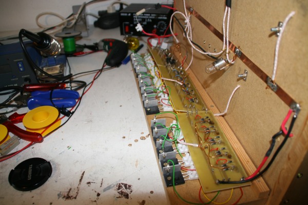

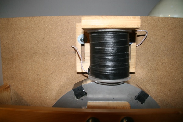

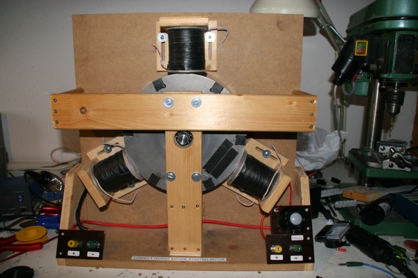

                    • I ran upstairs and shot some pix. Here is Machine 3:

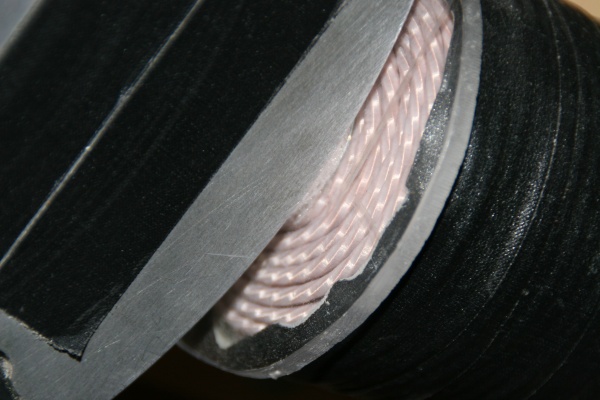

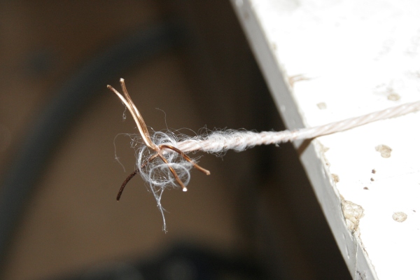

                      • The wire is probably the equivalent of 19 AWG- litzed in 5 strands and spun with a fine silk covering. Made to order. So you see I have some very low impedance coils. Might be wrong?!
                        • Since the wires are pretty thick there are not too many turns on each coil...
                          • Here you see the windings. This machine ran well on the BD 243 Cs but since I blew it I decided to put in the MJLs and I can't seem to get it up and running again....the base resistors are all wrong.On the 243s I could get this to run in solid state mode / 36 Volts in 12 volts out. Charged my 100 AH batts in 12 hours. But the 243 Cs are a bit too fragile for my tastes and my stupidity...
                            • The backstage wiring is a mess right now and I am working on it. As you can see I put the transistors on blocks to be able to change them without ruining the boards by solderin them in and out.
                              I will finish this properly once I get the right values...
