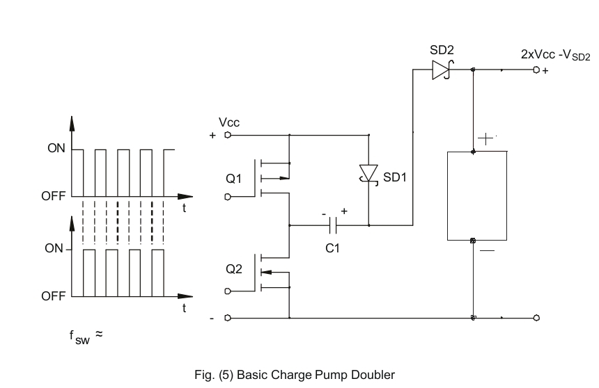

                      If the batteries are being pulsed with short, intense
                      pulses of 2 to 5 microSeconds at 1 KHz or more you
                      may find that they will charge effeciently while
                      'on-line' with a load. Providing the load isn't too
                      heavy.
                      It is best, though, to charge/rejuvenate/desulfate a
                      battery that is not being loaded as you've suggested.
                      The principle behind the Solar Power Amplifier is
                      relatively simple - it is basically a 'charge pump.'
                      The attached diagram is as old (or perhaps even
                      older) as the 555 Timer. But with the advent of
                      high current, low loss MosFets is more useful than
                      ever.
                      To emulate the functioning of the Solar Amplifier
                      you'll want to have a fairly large 'bulk' storage
                      capacitor from Vcc to Gnd. Capacitor C1 is then
                      alternately Charged from Vcc, then Discharged
                      into the battery in series with Vcc to provide the
                      Voltage Doubled Impulse.
                      C1 may be smaller than the Bulk storage capacitor
                      of Vcc. The circuit may be pulsed at any convenient
                      frequency consistent with the ability of Vcc to
                      provide charging current to the battery being
                      rejuvenated.
