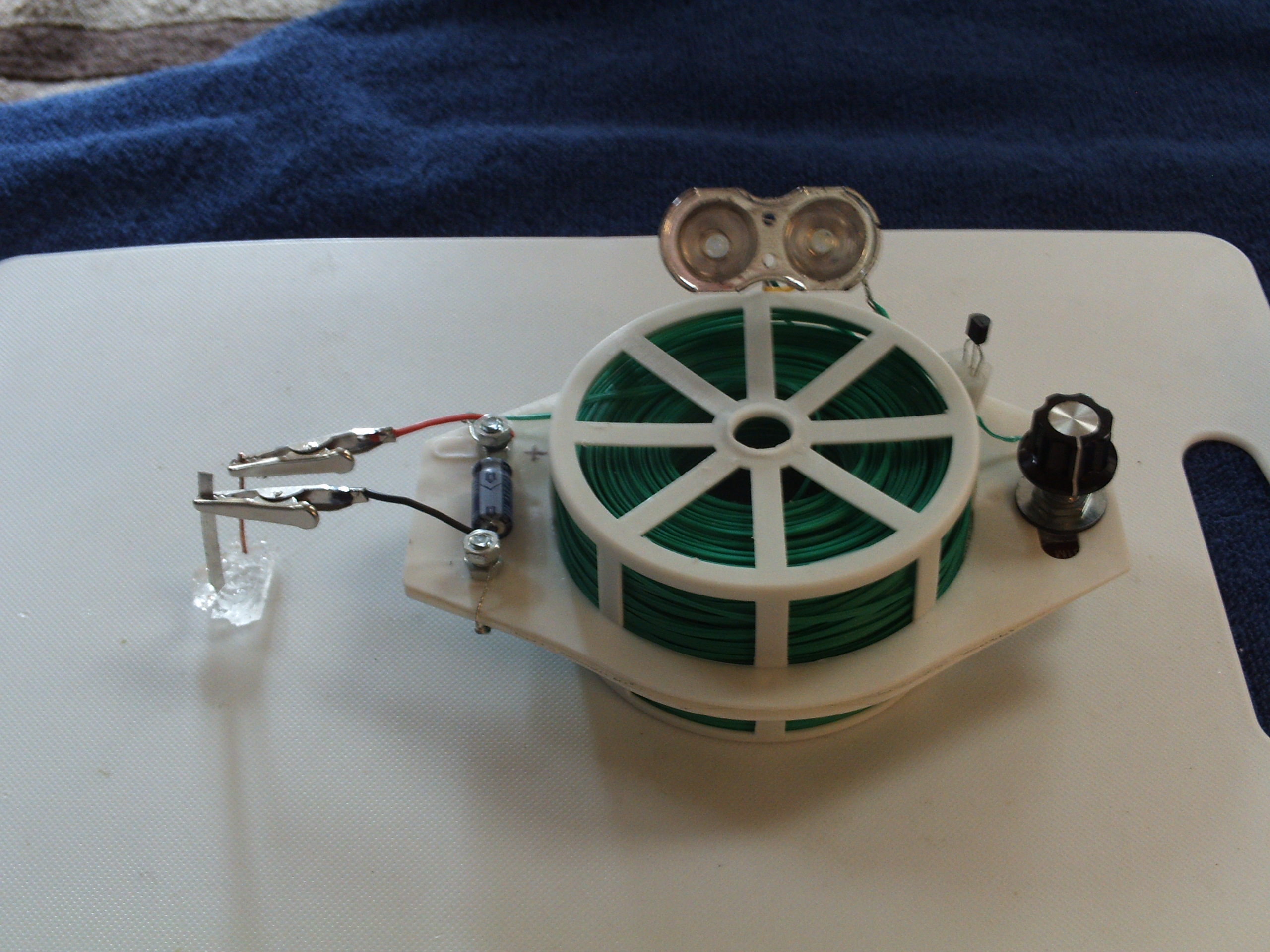

        At the end, something that sorted a few wonderings out for me. The Ha'Penny oscillator had been running for 5 days straight, from a 1F supercap that was sitting at 0.939V when the run started. Over the last day, the voltage went from a mere 0.412V to 0.406V and would rise a little, dip a little all day. The oscillator flash rate got slower over the 24hrs, the voltage was there, the current wasn't, SAME as these crystal cells behave. The oscillator has now stopped and the supercap still reads 0.408V

          Here is a video of Penny No. 2 running off a single crystal cell that was made by combining Rochelle and Epsom salt into a single "grown" crystal. It took weeks for the crystals to form and I don't know why. I used copper and magnesium electrodes with point contact on the crystal. I do not know what the dynamic is of the cell. It may be that the action is taking place on the surface of the crystal or maybe internally. I don't speak "Penny oscillator" or she would probably tell me what is going on.

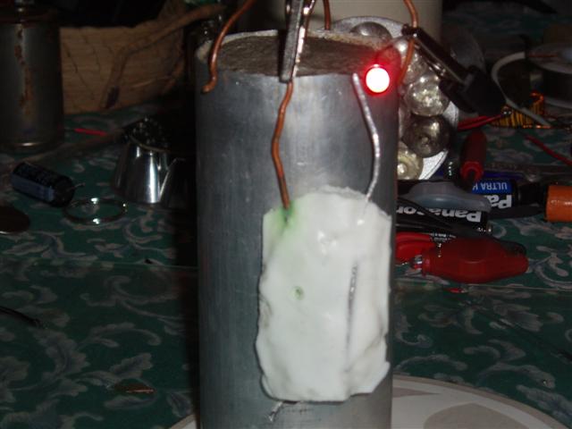

              Steve this "combo" crystal that I showed has a moist sticky coating and seems to sweat. Even after I rinse it off and quickly and carefully dry it. I don't think that this is the right crystal for what we are doing. After I made the video the electrodes melted down through the crystal almost like it was an icecube. Very strange. Disappointing but interesting.

                    • Just sharing something interesting. I have many cells built and some as old as beginning of September. They all come down in voltage and brightness. None are using oscillators, they all feed an LED directly.
                      I took a few of those cells and added a drop of water and voila, as expected, they sprung to life again. What is interesting is they sprung to life but stronger.
                      I don't know if its just galvanic, although mostly probably is, but that would not explain why they would come back stronger. This effect is repeatable. All one has to do is have a cell go really dry and latter add very little water and it should be stronger.
                      I think as the water dries the crystal lattice is formed and when new water is added that new water allows even more power to be extracted from the formed crystal lattice.

                        I do the same with my cement cells which are months old, and other cells as well. As it rains here quite a bit, I set the lot of them in a case, and out in the rain, to soak all night long. The cells are always ready to go in the morning. Problem is that they do loses power once dry again, but still output at least 1/2 the voltage even dry. They can work dry also, just not as well.
                        My big capacitor cement cell still has 1.2 volt and 30 mA. after 8 months or use. It does like a soaking in the rain, I see no oxidation at all on it, yet.
                        BTW that is a glue cell connected to the capacitor cell, which is about three months old, and still outputting (just white glue and table salt). Hail galvanics... as it's all I've ever made.
