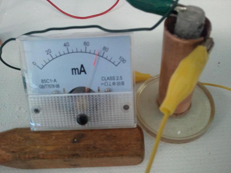

            • Trough cell update
              Yesterday I posted a picture of the new cells I made and I have good news and bad news.
              The bad new first - without referencing the Gorilla Glue cells (a bust) in all but 2 of the cells the magnesium detoriated at the entrance to the cell. The only thing new in these cells were the yellow wood glue and painters tape. These cells were producing higher amperage then I have been getting from those cells.
              The good news - the 2 cells that used silver leaf and started so poorly have climbed to 1.42 volts and 3.8ma after a full day plus. These cells started at less than .5 and after 6 hours went up to .8 volts. This is very interesting, so I made another last night that I will encase in liquid plastic tonight.
              Now - the weird news - using a piece of copper pipe and magnesium rod I layered Elmer's School Glue, Epsom Salt/Salt Substitue. Then I heated this mix at 175 degrees for 20 minutes. When it cooled slightly I tested the cell. 1.25 Volts and 85ma. After 12 + hours they are at 1.2 Volts and 75ma and the meter was rising when I took the picture you see below. I will seal this cell with liquid plastic tonight also. While this is certainly galvanic, I will monitor to see how long I can get usable output.
              Brad S

                    • copper magnesium alum cell
                      there is definitely some solar cell type action going on in our cells.
                      we have just about run bone dry on ours now. we are down to 1 volt. the little WM has stopped about 3 times in the last 24 hours each time we spin it up and it goes for a few hours - time to switch over to an LED.
                      what we did to narrow down the solar thing. simple enough.
                      shine the light on the cells in the fish tank w/ the motor running and thermometer - the voltage rises. note temperature. then put paper all around the fish tank, blocking any light except a small hole to see the temp. maintain the temp. - voltage decreases.
                      the rise and fall is significant enough to make the conclusion.
                      first test:
                      start temp - 65 F
                      start volt - 0.99
                      end temp - 72F
                      time - 10 minutes
                      end volt - 1.12
                      second test:
                      start temp - 72F
                      start volt - 1.12
                      end temp - 74.8
                      time - 10 minutes
                      end volt - 1.02
                      there is still a small chance that the copper is being heated more than our thermometer would suggest. during test 2 we placed the heat source as close to the copper, on the other side of the glass, as we could to try and eliminate that possibility.
                      I know it is not intended to run this cell bone dry. we just want to take it there to see what happens. almost 2 weeks now - pretty awesome. we'll see how long the light will last. the potential is still there 4.53 volts w/o load.
                      Patrick

                              @minoly:
                              I agree, while preparing some cells last night for sealing I noticed this. While cleaning the copper pipe and magnesium rod cell for sealing, I noticed that the heat from my hands caused the current to increase. After letting the cell sit for a while, I took a 9LED flashlight to look and see if the area where the seal was going to be was clean. Again I noticed the current increasing and I was not touching the cell. With this information and remembering your post, I pulled my 2 copper magnesium alum cells that I injured in the ultrasonic experiment and measured them. 2 in parallel were measuring 1.54 Volts and 1.8 ma. With the same flashlight, shining approx 1 inch from the cells for several minutes, I got 1.57 Volts and 3.3 ma. Before shutting down I measured the cells again and got the same 1.57 Volts but 3.0 ma. Then I placed these cells in a cardboard box with the leads coming out and covered the box with several shop towels. This morning the cells measured 1.5 Volts and 1.7 ma. I will leave these cells in the dark until the weekend when I plan to put them in full sunlight and measure again. Thanks minoly for showing us this.
                              Just tying to understand, is it possible the electrode potential is establishing the voltage parameters and the photoelectric is controlling current?
                              @NickZ:
                              Mixing the crystals in epoxy and putting in the electrodes appears to be a bust. So far no voltage or current. I will let them completely cure and measure again to be certain this is right.
                              Brad S
