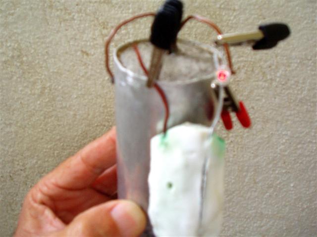

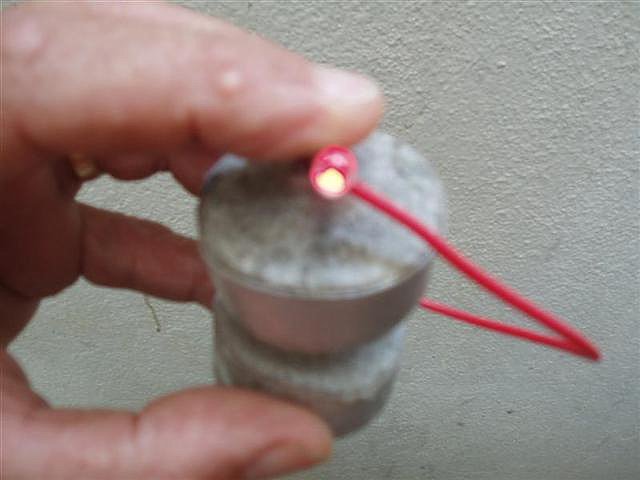

              • Guys:
                The glue table salt cell I made is still dripping salt water out of it after two weeks. It is still producing the same output as before. Trying to further charge these cells from another battery or even connecting them in series to my cement cells does create more oxidation on the electrodes.
                An interesting observation: My capacitor can cement cell is too low in voltage to light a led by itself, but, if I charge it for only a few seconds using a 9 volt battery that only has 2 volts of charge left in it (dead), it will charge the cement cell in only 10 seconds (just like a capacitor) that will allow the the cement cell to light an led just by itself for several minutes, and even at a lower light intensity for hours, or even days at an even dimmer but still visible output. No capacitor I've seen lasts that long, on a 10 second tap charge. When connecting the glue cell in series with the cement cell, the led light does NOT go out.
                If these cells were just galvanic in nature, then why do all the other galvanic commercially made batteries all discharge, but these don't ????
                I really feel that there is more to it, and that what is really happening has just not really been developed to a useful degree. For a reason.
                The two different metals are working like two different little antennas drawing in energy from the surrounding air, separating the charges, and allowing the cell to produce useful electrical power. That is my take on it.
                Salt just accelerates the process, it does not create it, but, it does so at the expense of the metals. The disintegration of the electrodes or plates may be controlled or at least delayed to a degree, by keeping the cells as well as the electrodes airtight. The white glue seams to accomplish this very well.
                Even the Lead-acid batteries work fine for several years, and finally lose the ability to retain the charge for the same reasons that these cells lose their ability to continue to produce it, oxidation, causing a resistance to the current.
                I removed the bottom of two small cement cells that had 0 v, and 0 watts showing on the meter, and allowed them to absorb plain water from a small puddle that they have been soaking in, since Lidmotor suggested it, some days ago. It really did not help to revitalized them. Another sad case. Which also leads me to believe that there is more to this than just the amount of water causing them to die, as the cement on both cells is quite wet to the touch now. These two small cement cells show no external oxidation at all.

                  • What I noticed in the last video about the rock cell, was that the flat copper/aluminum plate also outputs about a volt, but several can be stacked to get 12 volts, and it would only take just a few inches of space, and does not have any oxidation, especially if the plates are sealed. If the plates were bigger they would have a higher output. It takes some mass in the metals to obtain any usable results, otherwise you're just going to light one little red led, and that's all. But, is that also Galvanic, or not?

                        • Ib:
                          I watched your video. The other guy mentioned that he gets 1 volt from his plates, not 1/2 volt like yours. But he did not mention the current.
                          I am still getting at least 30 mA with my cement cells, so there is something different than on your results. Maybe the copper-aluminum plates need a different material between them to show a higher voltage and some current too
                          Remember that my cement cell use a pound of copper in them, and not just an ounce or less.
                          My glue cell is still getting more green forming and less voltage, as time goes on. Maybe oxygen is also needed for the reaction to take place, and if the cell is sealed it might not produce current. I don't know. But, I do get some current from my cement cells, and there is no oxidation on the capacitor cell in the picture, at all, after months of constant use, not just a short circuit.
                          I have given up on these type of cells. Sorry guys, but that's it for me.
