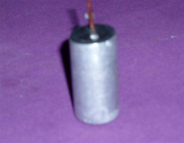

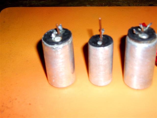

            • All:
              I just made another quartz/carbon cell this morning, my smallest and strongest cell yet. It was also made using a capacitor can that is a bit smaller (1/2" by 1 1/4"),than the previous two cells. In this last cell I ground down pure smokey quartz crystals points, not rocks from the beach. This small cell outputs 50mA and nails the meter, and stays there, and even goes up from there (with a load from the meter).
              The cells have the rubber plug on the top of the aluminum can, so they should be fairly hermetically sealed, and the mix is also pressed down tight, plastic insulator on the inside of the can bottom, as well as the top, under the rubber plug.
              I also got my first crystal rock cell to nail the meter at 50 mA also. Both cells are full of quartz. The quartz crystal points finely ground down work the best, with only minimal amount of carbon used, just enough to get the crystal to conduce.
              Seams like a good start on the crystal cells, as these are made with about 75% quartz, 20% carbon. Three cells did last all night long, with no noticeable drop in led light intensity. No additional water was added, no heat, nor any doping. Pictures later today, my camara is charging
              Although at first the carbon only cell performed better, but now it is the lowest output between the two other quartz/carbon cells.

                    • Slider and All:
                      Sorry to hear about the thumb, it almost happened to me.
                      I just cut the D cell open using a shovel, by giving it a whack right in the middle.
                      The D cell that I used is not from an alkaline battery, I don't know what kind of battery it is, as it is so old, that there is no information on it anymore. All I can tell you is that in the can there was carbon powder or grains, and in the center there is a whiteish powder sticky substance in a paper type cylinder. It might be carbon-zinc.
                      Here are a couple of pics of the little cell that I made today, sorry they are so blurry, I'll take better pics next time.

                            • @ Silver to Gold:
                              I looked at the Nurd Rage video that you had sent a link to. Some useful info there, but my old D cell battery was not like the one in the video. There was no carbon core, and the center had a whiteish gum material. In any case my new cells seams to work, so far. Mostly what I used was quartz, the carbon is the only needed in minimal amounts as a conductive binder.
                              The pure quartz points I used today really make thisnewest cell different, and better than the carbon only electrolyte control cell that I made yesterday.
                              But even the quartz beach rocks and carbon cell is doing well.
                              I made 4 new cells out of one old thrown out battery, by mostly using quartz.
                              Still need more time to see some duration test results.
