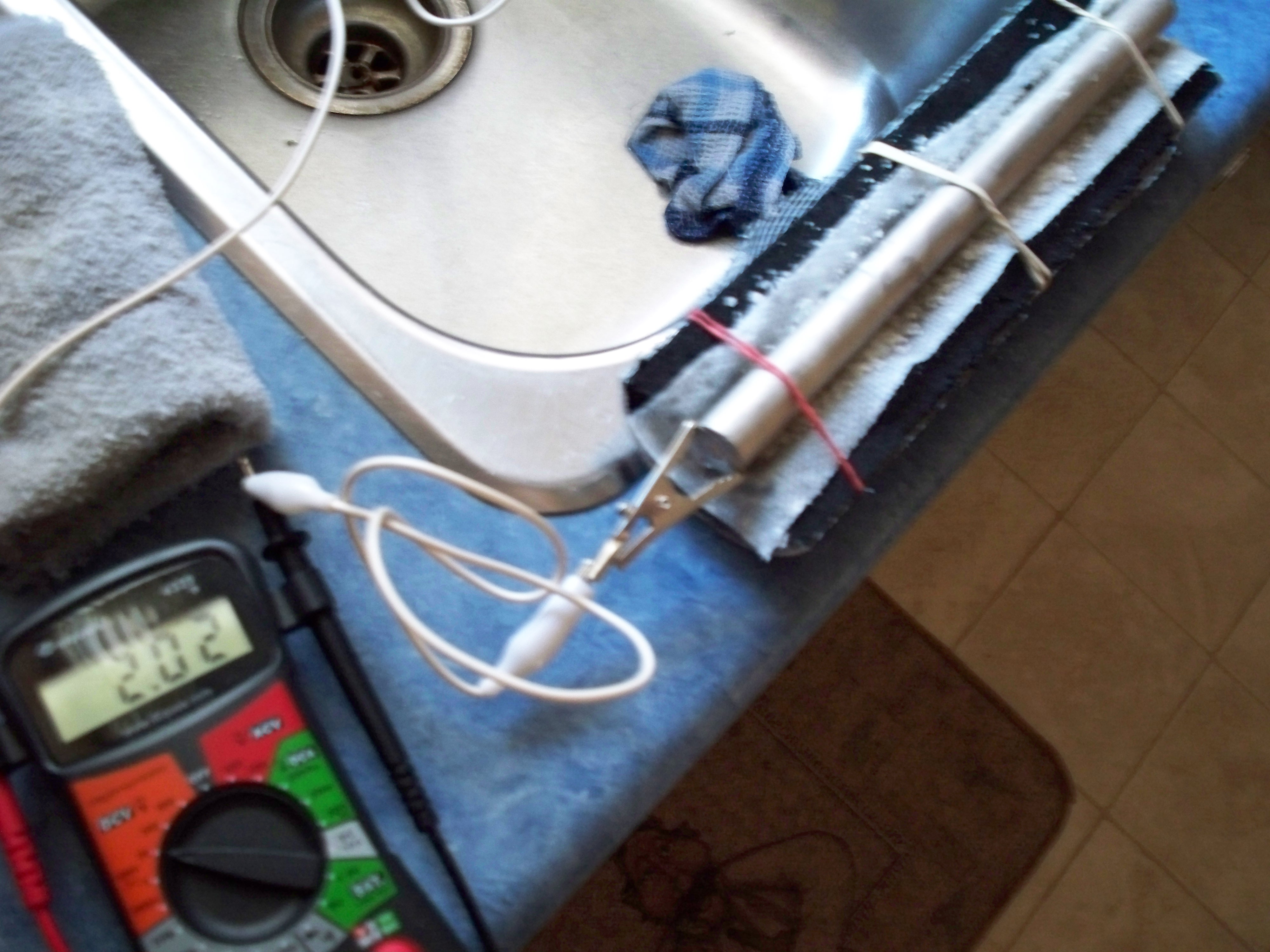

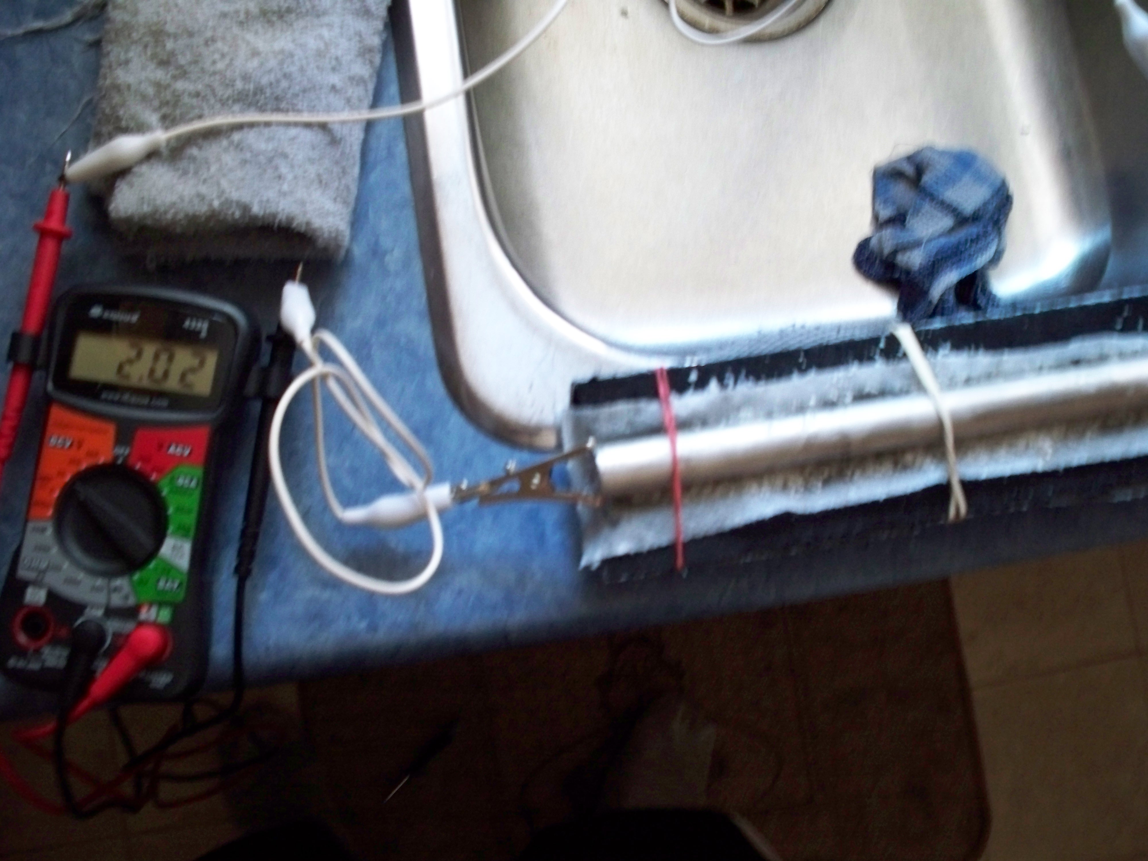

          • Over 2 Volts
            I took a carbon water filter and magnesium water heater anode and put them together with alum and paper towel in between. Right after you wet it with distilled water it cranks out 2.02 Volts and over 50 milli amp. Once you load it with a load, the amps drop pretty quick. If I let it dry for 48 hours voltage rests at about 1.56Volts without a load and amperage is pretty much none.
            Carbon water filter is 9.5" long. (split in half)
            magnesium .675" dia
            When we figure out how to increase the amps I will be really happy

              • Brad and All:
                Thanks for your report on your new cells.
                I made some gelatin beach sand cells, using aluminum cans, but I found that the sand all goes to the bottom. So, the mix needs to be thick enough to avoid that. A mix that solidifies with expandable gummy like ability would be good, as the cement cells in time will shrink away from the aluminum cans, which can reduce their efficiency.
                The gelatin cells turn to liquid mush in my climate of 86 degrees.
                A consistency like that of semi-dry silicone glue would work well for a cell, and hold the mixture in suspension until it firms up a bit. Bees wax would also be good to try.
                To obtain more accurate readings of the capacity of these batteries, they need to be put under a load, and allowed to run for an hour or two, even if it's just using one led bulb as the load. Then when readings are taken, they will reflect a better idea of what these cells can do.
                NickZ
