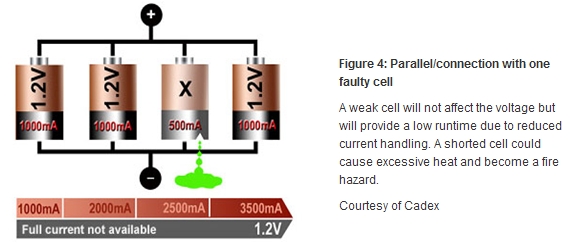

                              I do not think this relates to the problem you are having based on the description you provided, however this is relevant to anyone connecting batteries in parallel. If the amperage is not matched up with cells, the total output is sacrificed. I believe that is why you noticed my cells did not add up correctly.
                              The attached image is from batteryuniversity, an excellent site for general battery information.
                              In case you have not tried, select 2 cells that most closely matches for voltage and amperage and connect parallel and see if the amperage increases. Again, this does not sound like the solution you are looking for but might be worth a try just to eliminate this as a possible reason.
                              Brad S

                              • Brad:
                                I have tried two or more of the exact same type cells in parallel and they don't gain in mAs, at all.
                                The leds will dim after a while even if there is enough current and voltage in the cells for them to be bright. Either in series or placed in parallel the leds get dim, even when adjusting or tuning with a pot. The Kooler type of Hartley oscillator circuit has not been of much, so far. It works but no better than connecting the leds direct to the cells. I'll try different coils on the backwards Jt and see if that helps.
